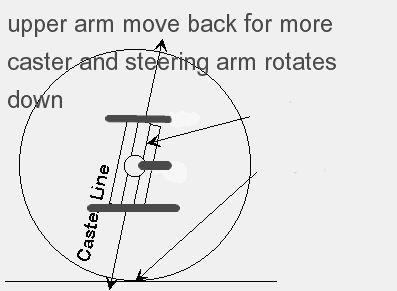

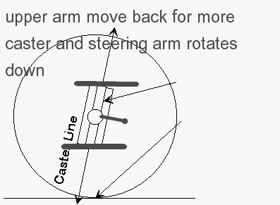

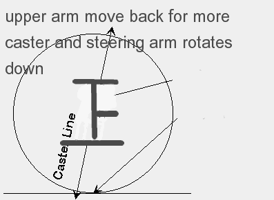

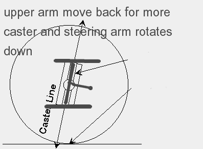

      heres a picture of the steering arm and control arm configuration on the car
      by lowering the upper control arm pivot points by .75 inch. This raises the front suspension roll center from below ground level, to a point well above the road. This will reduce the angle of the lower control arms and make them more parallel to the ground, giving you a more favorable camber curve. The new holes will also move the top of the spindle rearward .25 inch from stock. This will create more positive caster, which will make the steering feel more "snappy.
      about the bumpster reduction, that's simple to understand, the Guldstrand mod moves the arm on 2 axis 1 is rearward, which rotates the steering arm downward and reduces bumpsteering just like putting a longer tie rod end kit
      Name:  z stock caster.gif
      stock control arms mounting
      Name:  z changed caster.gif
      Guldstrand arm mounting
    16. #236
      Nov 2010
      Ventura County CA
      556
      With all due respect (and I really do respect you, you've built a hell of a car), I disagree with your statement about the lower arm residing at a different angle as a result of the G-mod. Yes the roll center moved and this affects a lot of things, but on this suspension design the static ride height is dictated by the lower control arm mounting, lever ratio, spring, and spindle.
      I have also done the G-mod (the hard way) using Guldstrand's templates and I did not see a shift backwards of 0.25". Yes, they do move backwards along the shaft direction, but because the shaft mounts at on angle on the frame (lower at the rear), the net result is only a downward movement. I think you can see it in your picture here; the old and new holes are essentially right on top of eachother. Regardless, even if the holes move rearward, static caster is something you would set through shimming the shafts. Having the holes further back does allow you to use more static caster, but that's only if you aligned it that way. If you aligned it with the same static caster and camber as you had before the Gmod (and all other parts are the same), your spindle is positioned in the same location as before and therefore there is no change in ride height or steering arm / outer TRE location. I agree that under cornering things will move differently with the G-mod and perhaps there is some bump steer improvement there, but I would not expect a significant change. Now if you aligned things differently or used taller TREs or something else, that could have a significant effect.
      Clint - '70 Nova "restomod" cruiser & autocross family car
    17. #237
      Lawrenceburg, TN
      4,098
      very interesting way to look at it, if you say that it only moves down and not back then how did the bumpsteer decrease with no other change than the G-mod?, in fact it decreased so much that I havent put the proforged tall tie rod ends on after we aligned it? and when i aligned the car after the mod, I put the settings back to what I had been running 0 toe in, 1degree of Camber, (David says maybe go 1.5, but Im sticking with 1 as a daily driver) I test the car every few weeks at the track twice a month track days (autoX and UFO) also the car is a daily driver(25 miles a day) to the shop and home, so every change is driven real world (10,000+ this year)
      the from what i can see the G-mod moves the mounting 1) down (roll center) 2) back (caster) 3) angle of tilt(antidive), so 3 axis I have the same templates at home I will remeasure, it would be interesting to find out what made the bumpsteer change, when Im down in Del Mar goodguys this November you should come out to the event and get a few ride alongs
    18. #238
      Nov 2010
      Ventura County CA
      556
      Did you change the static caster?
    19. #239
      Lawrenceburg, TN
      4,098
      Quote Originally Posted by TheBandit View Post
      only the amount that happens from the mod
    20. #240
      Nov 2010
      Ventura County CA
      556
      Okay, so you did the G-mod and upon realignment, only adjusted camber and toe? That may explain what you're seeing. Even if holes aren't shifted rearward, when they move down the upper arm is at a steeper angle and due to the inclination of control arm shaft, there is caster gain (the balljoint swings up & backwards as the UCA travels upward). Your new alignment probably has more caster than your previous alignment. I'm not sure how much exactly - worth measuring for sure and I'll bet that is where your bump steer change is coming from.
