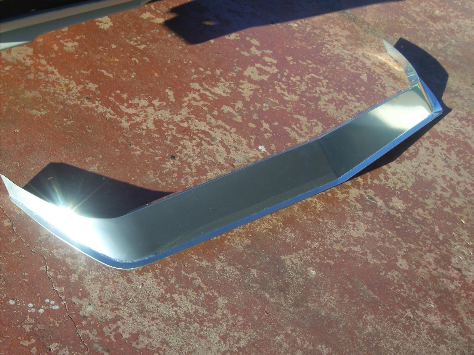

      can you guess what this is??
      can you guess what this is?? new part for my car

      Front airdam/spoiler Looks very nice!

      that was to easy just one guess!
      Looks awesome on the car!

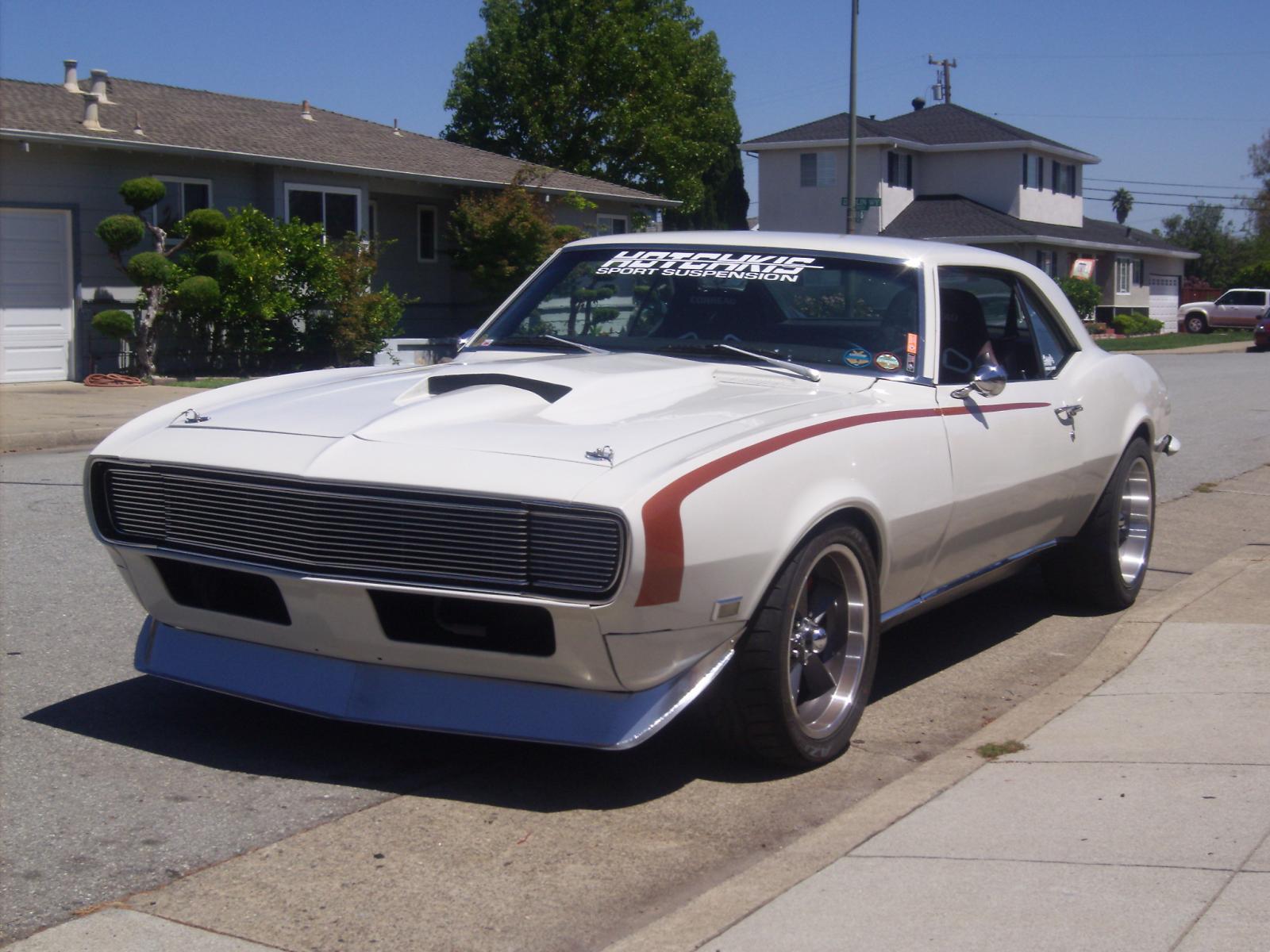

      test fitting the new spectre performance 1st gen camaro spoiler!
      here is the test fitting of the new spectre performance 1st gen camaro spoiler! fits well, light weight, I will run it for a week or so to see how, if at all, if it interferes with anything daily driving, then I will pull it back off and paint it (maybe black or body color)
      how much did that little guy cost you and where did you get it? me likey. i was going to have someone build me one similiar to that one but if the price is right i will just buy that one and call it a day.
      just out of curiousity. you plan on selling/keeping the spoiler by randy?
      car looks great

      nevermind. did a search and found it pretty quick. $499 at jegs.

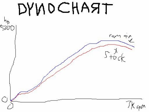

      Got my new dyno numbers in! should be killer for the end of the season!
      Nice! With that kind of power comes great responsibility!
