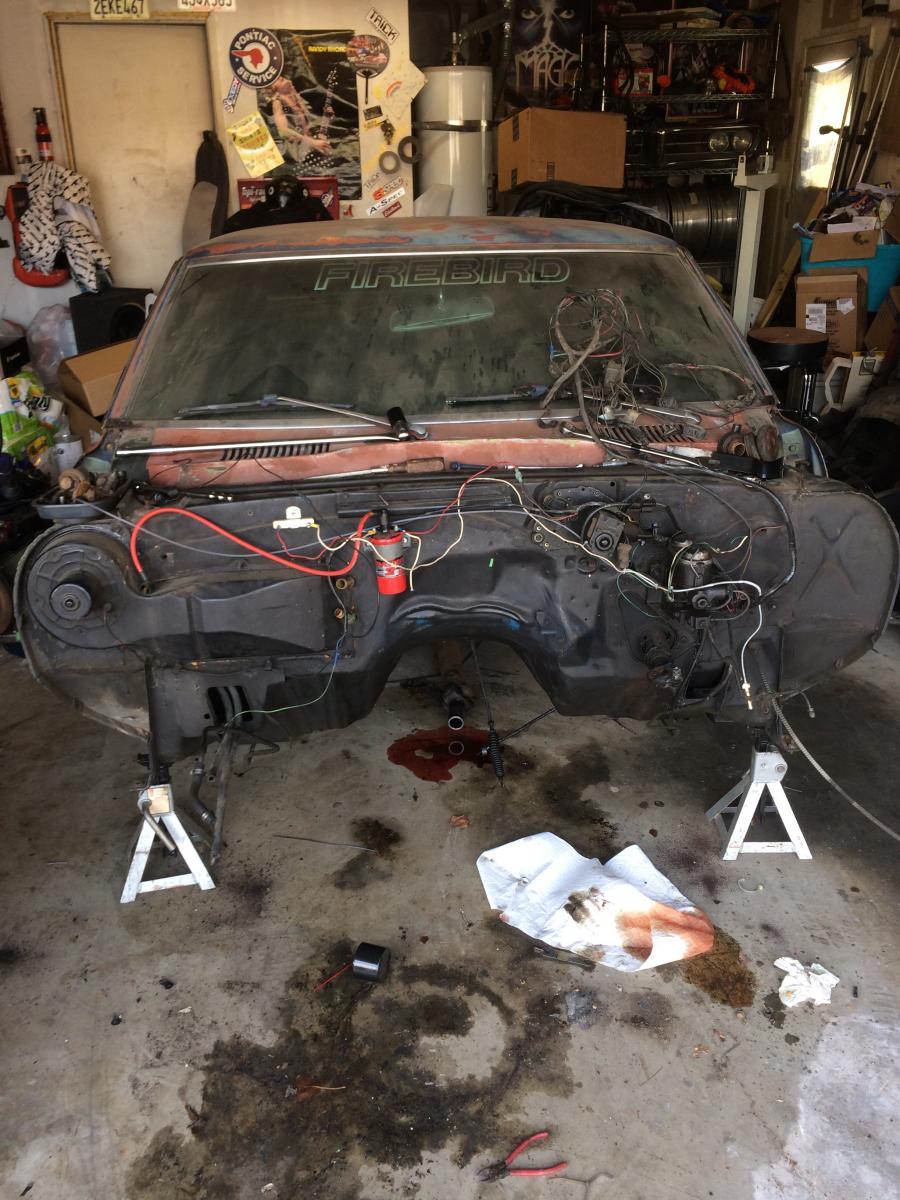

      Well I do not know if I will get it running by December but I will try!

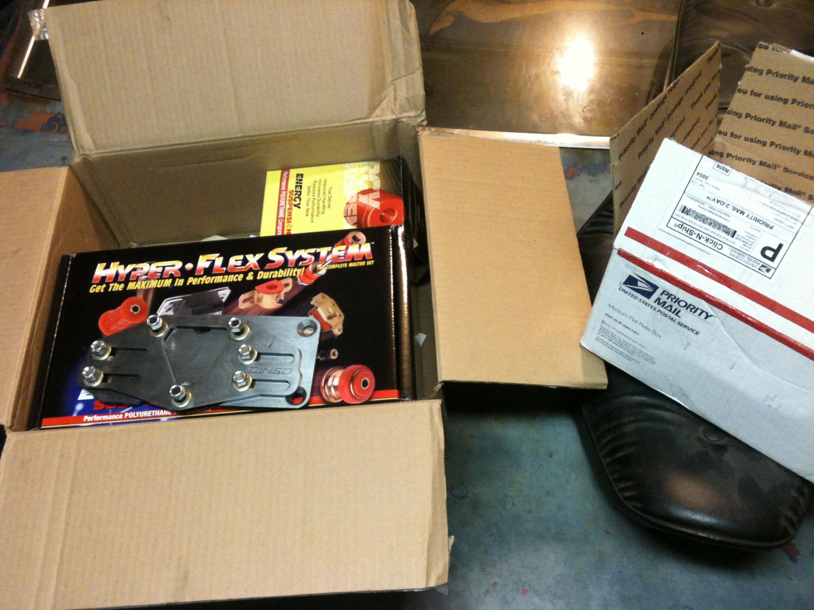

      Small update I have been chugging along on the car, got a new job so that makes buying parts great!
      I picked up a master kit from energy suspension, also picked up a set of Dirty Dingo motor mounts.
      my next order should make some real progress.

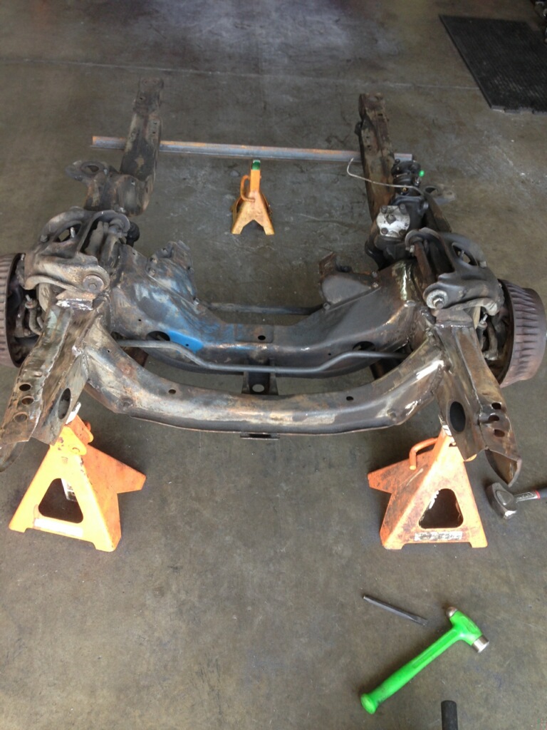

      I did not make my deadline of having it running by December. However the project changed directions for the better.
      Pulled the subframe, I have it over at a friends ship and we are making necessary repairs to the frame and I we are seam welding it, switching over to speed-techs Chicane coil over set up, and will be off to powder coat.

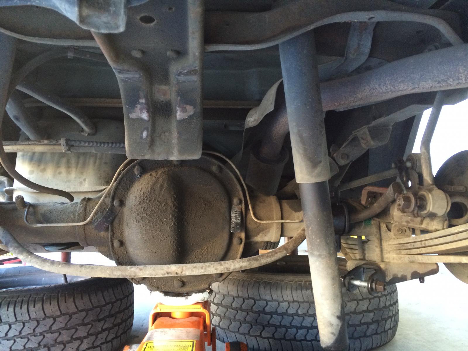

      Oh, I also took another forum members advice and snatched a 8.8 from a ford explorer. Will be swapping the axles out to moser units.
      I guess not turning back at this point.

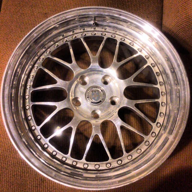

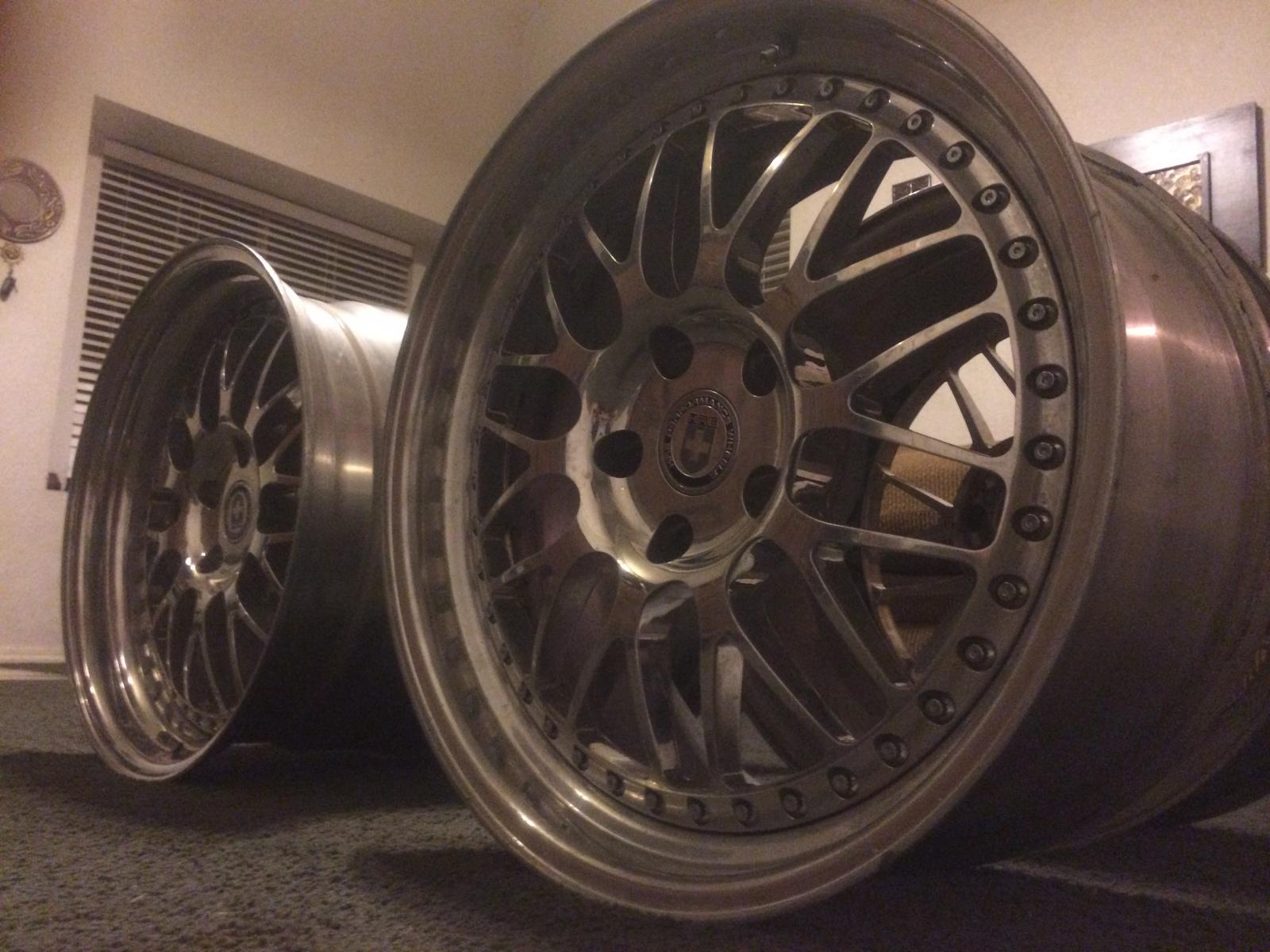

      I might have also picked up a set of my favorite wheels for dirt cheap. HRE 540s
      Name:  photo 2 (2).jpg
      Name:  photo 1 (2).JPG
      Sorry for crummy photos.

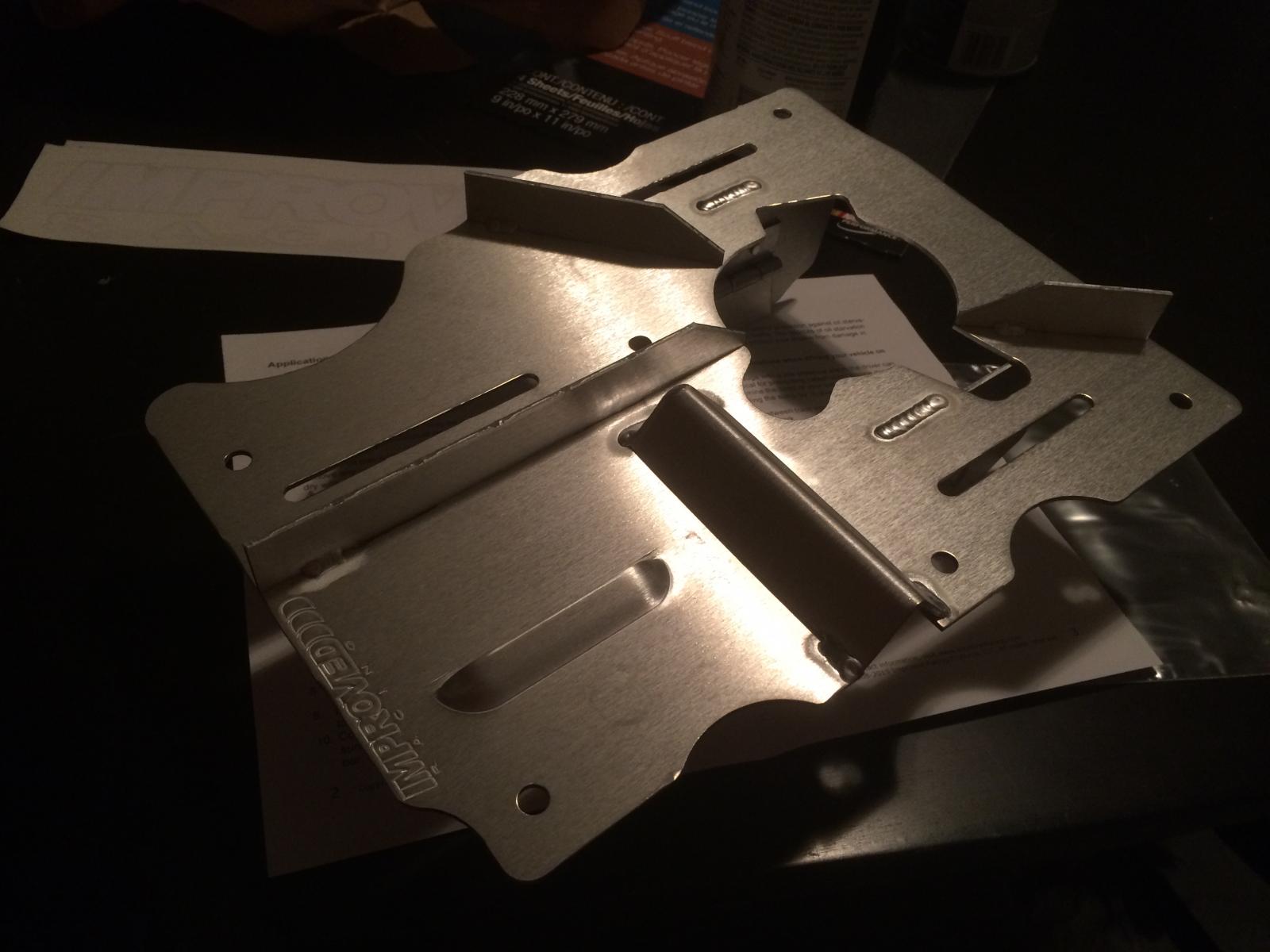

      Ordered some parts for the LS1 from Improved Racing. Great company! Ordered a LS1 oil pan baffle, LS6 PCV assembly, and all of my gaskets. But dummy me forget to order the coolant crossover tube.
      Speedtech Chicane Coilovers with be here Monday, then once the brackets are welded up, the frame will be off to powder!

      NICE, i love how you swapped over to the ford exlorer rear end. BTW no need to swap over to moser axles... the 31 spline axles on those things are beefy enough to wheelstand a first gen F-body without worry. i hope you got posi with that. 373 or 411 gears? or were you lucky enough to find a 355 explorer rear?
      also, the explorer 8.8 is basically a ford 12 bolt, c clips and everything, so just pull out the axles and take them to a local machine shop and have them drill the axles and rotors for 5x120.6 and you'll be just fine... drill in between the 5x114.3 holes so you wind up with 10 holes.
      OR just order custom moser axles like you wanted and order them in 5x120... won't cost you any more really. and then just drill the rotors.
