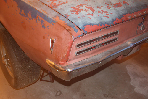

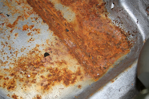

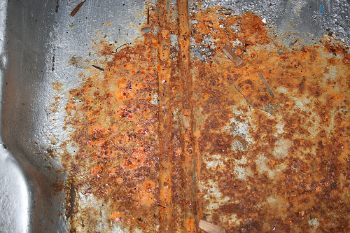

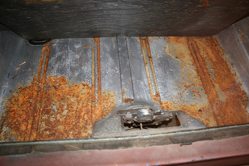

      Here is the most rust on the car there are only a few holes in the trunk. Some rust under the right rear corner of the rear window, and some damage under the left tail light.
