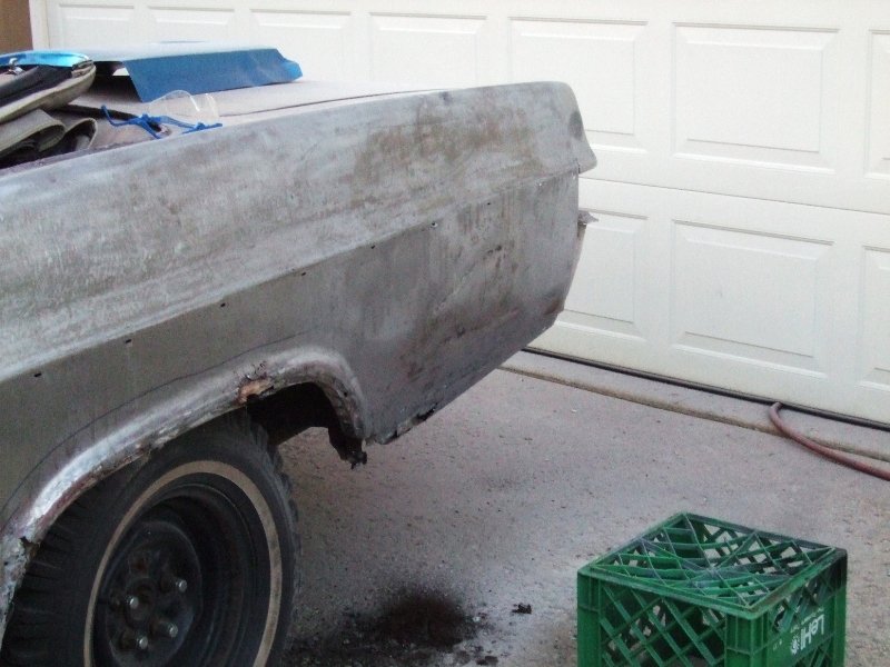

      This is on a 66 Impala Convertible so it never had the benefit of a roof structure.
      Poor old car has obviously led a rough life, been hit a few times, abused, etc.
      I'm doing a budget build up and learning some welding and body skills but this 'pop'ing thing has me beat.
      In an area on the drivers rear quarter panel, above the body-line, there had been some kind of damage to the top and side. I can push on it with my palm and it pops in. I can then reach in the trunk and pop it out. In either position, there's gonna be a need for some body filler.
      What can I do about that metal? I kinda want to heat it but I don't have an acetylene torch. I was hoping it would 'flow' into place.
      When it's in or out, I do not see any "creases" that would seem to exacerbate or cause the problem.
      What to do?
      This doesn't really show the issue, but may help to visualize. It's that dark-ish area above the body line. We've already patched up the lower quarter and wheel lip.

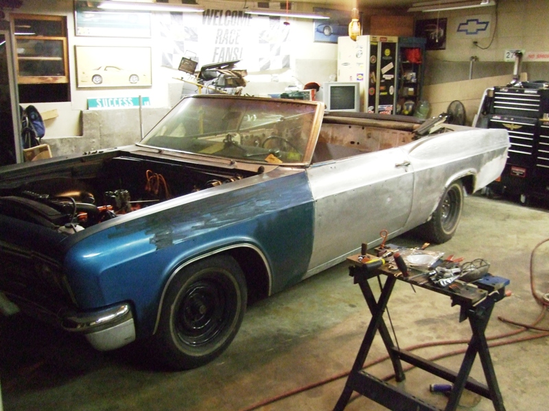

      You can actually see the popped area is 'in' from far away in this photo!

      I'm a newbie w/ metalwork, but it would seem to me like it needs to be shrunk a little.

      you can use shrinking disk, it beats the price of torch setup , there are guys on ebay selling them , even heat gun will work,

      You have an "oil can", and yes, the metal just needs to be shrunk. You can probably find lots of how-tos on the net if you google shrinking metal.

      Even though I was only using a propane-based radiant heater attachment, I think the 'oil can' problem is FIXED!
      My new problem is that when this panel was "repaired" long ago they apparently beat the **** out of it with a hammer.......and a pointy one at that! Yeesh! This panel looks like an arial view of the Andes mountains.
      I'm trying to hammer & dolly them but I'm new and there's over a dozen of them. Sometimes it's like fixing one valley causes an issue right next to what I'm trying to fix! Arrrrgh.

      Using pick hammer is a butcher way to shrink and control metal, so you might have to deal with more shrinking when you're done flattening those spots

      Some advice: When you're done, use some panel adhesive and reinforce the inside of those quarter panels BEFORE you block sand and paint. As bad as it is now, the "oil can" situation gets real nasty after you realized that while block sanding the flexing metal resulted in the panel not being prepped right. Even if you shrink it, panels like you're working on can be a real challenge.

      Using a mig welder in the "oil can area" place a few tack welds . With a wet rag wipe the area to cool it fast . This will shrink the area . take your time .
      You can all so stretch the outside of the oil can with a hammer and dolly a little at a time . Yet again take your time .
      If you have a mig thats my favorite !
      Never use a torch !!! The pick hammer would be a better choice in a pinch

      They make a shrinking hammer that twists as you hit this little unit ought to be named one of the best body tools of all times.

      So, as I mentioned above, the oil-can effect is fixed but now I'm working on this mess. Believe it or not, it was worse! This is decent right now. I just need to work the two raised area's back down.
      I'm hoping a shrinking disc will help here. Using a regular propane torch is a bit unpredictable so far.
      It's not quite the surface of the moon, but it is a little like a pepperoni pizza.
