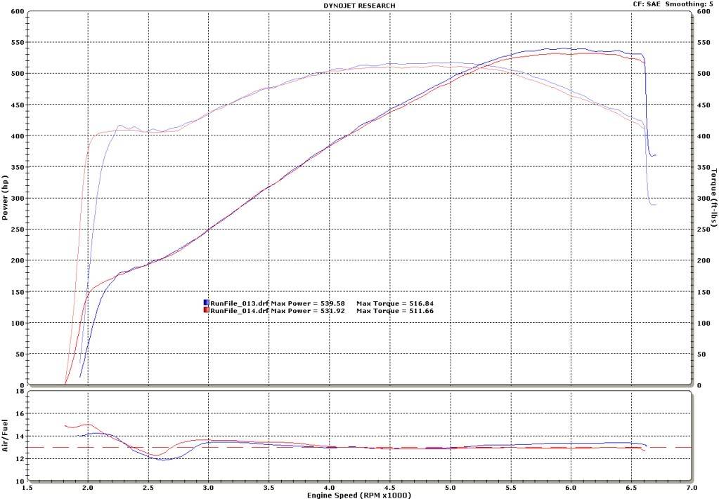

      I don't have my original dyno graph to show, but with a Much larger cam (243/253 on 113+3 .650 lift) my car only managed 500 rwhp and 475 rwt. I was very dissapointed to say the least and the drivability was poor. I then changed to the Katech Torquer cam to gain more torque and drivability (220/244 on 110) and got a retune. More torque for sure, but still didn't idle well and proved to be very difficult to manage.
      Now to Ed at VA speed. He came highly recommended to me by a couple of local guys and by following him on LS1tech.com.
      Ed discovered some key issues in the computer right away that no one else had seen, and ultimately discovered that the MAF was not working correctly.
      Here are the results:
      I drove the car home 3.5 hrs and picked up 2 mpg (23mpg at 70mph, Ford 9inch w/3.70 gears and t56) with 50 more hp than before, WOW!
      At 70 mph I can cruise with the cruise control on with zero surging (never had a problem with that anyway) and when I come to a stop regardless of how I do it, it settles in at an 850 rpm idle.
      First and second gear are a major exercise in throttle control and after 3 years of frustration, I FINALLY enjoy driving my car!
