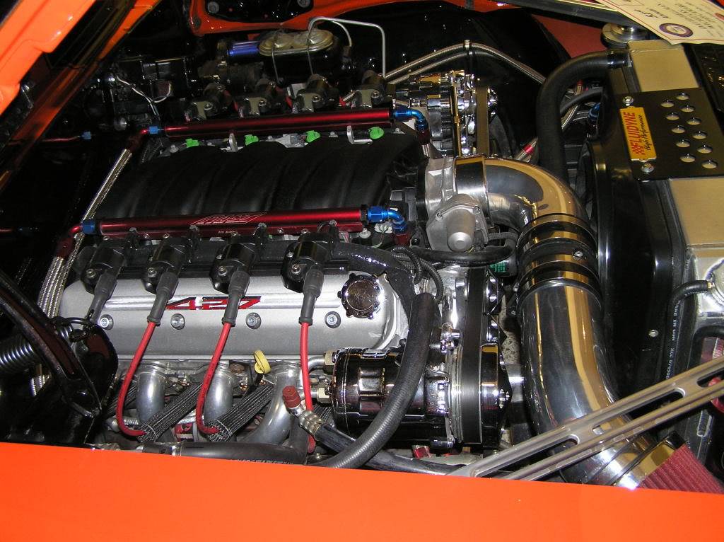

      467
      I have this Street and Perfomance set up for sale. I used it for mostly show since the spread layout looks so tough.
      Includes damper, belt, PS pump, AC condenser, High amp alt and upgraded bearings. PM if interested. I'll make a hugh killer deal.
      I'm in the process of adding Hotchkis handle bars and this set-up would not allow it without mods.

      From the looks of that A/C unit, I think my Alston support braces might be in the way, much like those Hotchkis bars. :( Too bad for me cause I like your setup.
