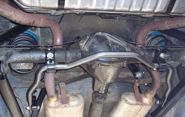

      Our tubular 1-5/16" front bar and our 1-1/8" tubular adjustable rear sway bar work really well on an A-Body. p/n for the front is 55703 and the rear is 55868 for a 68-72 GM a-body
      Here's a picture of our rear adjustable bar installed.

      Mounting the sway bar to the control arms like the stock bar prevents the suspension from articulating and causes binding. Mounting the bar so that the control arms are free to move allows the suspension to articulate better and results in better ride and handling. My 68 Chevelle was one of the development vehicles for our new adjustable rear bar and there was a pronounced difference in vehicle dynamics between a stock style bar and our new adjustable bar. I was able to take one corner 5 mph faster because when using the stock style bar the rear axle would tend to chatter in the bumps while the new adjustable bar would allow the suspension to absorb them.
