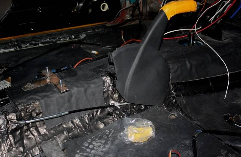

      While I haven't completed this I wanted to do the same thing. I have a Chevelle but its the same basic concept as your Camaro. I was looking at Lokar but didn't like to small round handle so I decided to hit the junk yard to see what was out there. What I ended up with was a BMW 7 series from the late 90's handle and cables. Its a nice leather wraped handle and a simple mounting base. I also pulled the cables but the ends that attatch to the brakes will not work and the length is wrong. If you can find somone to modify the factory BMW cable you can possible tie into the original rear cables. If you upgraded (I have LS1 brakes) it will probably mean a set of Lokar or custom cables.
      Someone had a Camaro that had a cable from each rear wheel come up to the end of the drive shaft tunnel. It had a bracket and attatched to a single cabe that went forward to the center mounted handle. I think it was all Lokar stuff but I dont remember what handle they used.(The BMW stye has two cable all the way to the handle)
      here is a pic of the BMW handle I snagged of the internet. Check eBay and you can find them for $20-$50.
