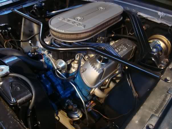

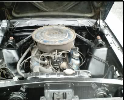

      This is the most current picture I have of the engine bay.
      87 GT 5.0 roller block with complete rebuild
      Trick Flow stage one cam
      New dual timing chain and gear
      Cran's 1:6 Roller Rockers
      Edelbrock Air-Gap intake
      Edelbrock 500cc 4 barrel carb
      Tri-Y headers
      Rebuild 93 GT-40 heads
      8mm wires
      Flowmaster exhaust 40 series
      Aluminum Cobra air cleaner
      3" tall Cobra valve covers
      3 core radiator
      Moroso front sump oil pan
      power brakes
      dual master cylinder
      CSRP disc brake kit
      all new front suspension

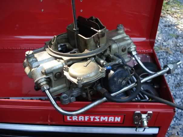

      Replaced the edelbrock with a Holley 650 double pumper. 10-12mpg!

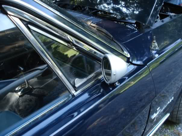

      added Raydot mirrors recently too

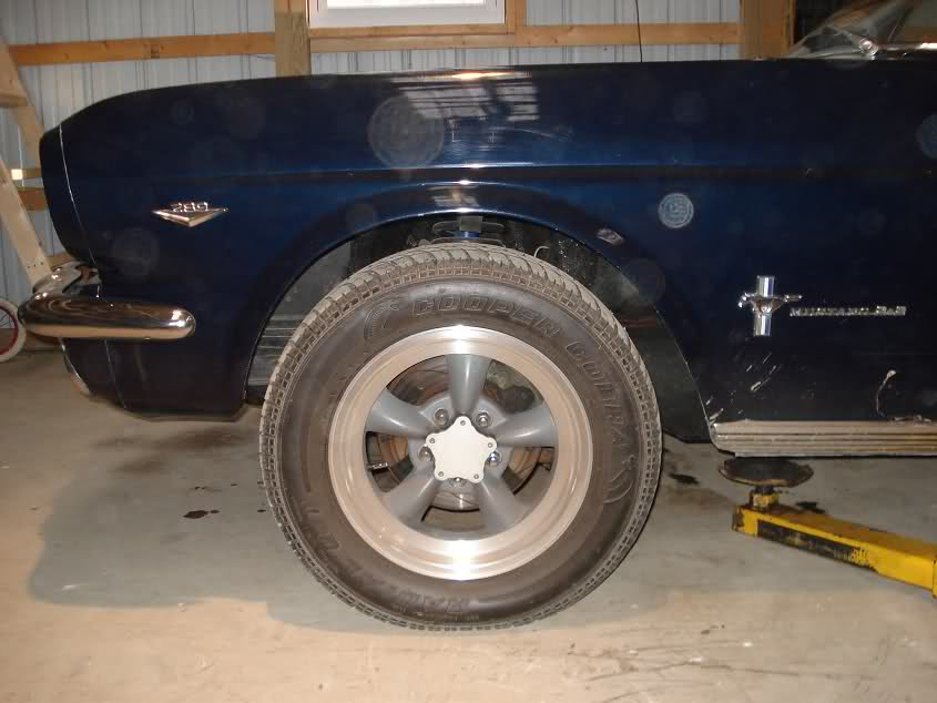

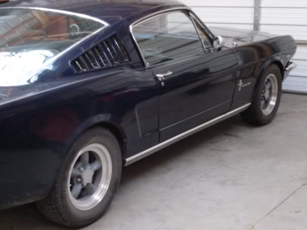

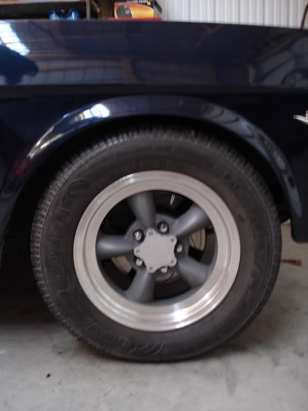

      I recently finished up the Shelby drop, installed high performance coil springs and the Shelby quick steer kit. With the new springs and the drop itself, the car handles so much better. Really happy with the stance. Before I left to go back to college, the front seems to have settled at a good 2" drop.
      Before
      After
      Sorry, dirty car.

      BTW, the pictured carb is not a double pumper, it is a vacuum secondary.
