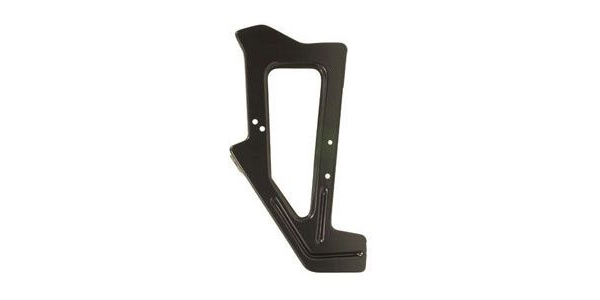

      Is the bracket for the hood latch, in front of the radiator needed, or can it be removed?
      It will interfere with the intercooler, so I wonder if I can delete it completely or if I should cut some parts to keep it. It also supports the panel in front of the hood, can it distord if I remove the bracket?
      Do you have an idea to replace the big hood latch release which will also interfere the intercooler? I would like not to drill holes in the hood and use hood pins. Is it easy to put latches on the side as Larry did?
