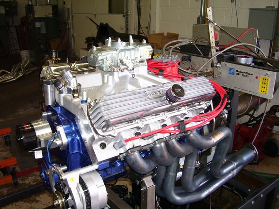

      I've had this car for a few years. Thought I would finally post some pics!
      My engine was built by Bill Trovato.
      1968 455 Block bored 30 over
      rotating assembly balanced
      Edelbrock Heads
      Edelbrock Torker Intake
      KB 455 pistons/pins 14cc dish 10:1 compression
      Cat H beam full floating rods
      Comp Cams hydraulic roller cam
      Comp Cams Aluminum roller rockers
      CSR electric water pump
      MSD 6AL Ignition
      2" Kooks Headers (Swain Coated)--3" exhaust
      850 Demon Carb
      11" Competition Trans. converter (3000 stall)

      How do those header fit in your chassis. I need to find a new set for my 67. Mine are messaged to much and looked like crud. But I will watch this build also.

      The headers fit great.

      Great looking engine you have there. Where did you get that cool shorty aluminum oil fill tube?
      I was going to ask the very same question.....

      NICE car - love the offy valve covers!
      BTW, you're teasing. We can see the motor on the dyno, so how about some numbers, eh? I've never met Bill T but have always heard he can build some killer Olds motors.

      Thanks--I think the valve covers give the engine a unique look---but they came without baffles and were a bit of a PITA! This motor is actually a relatively mild build. It puts out about 500 HP/550 TQ. I'll post the dyno sheet when I get home tonight.

      That's an oil fill tube from FCR Performance to my knowledge.

      Yes the oil fill tube is from FCR Perfromance (fcrparts.com). If you click on the "Mew FCR Parts" tab you can see them on the bottom of that page.

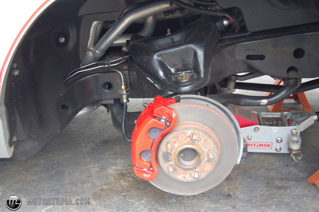

      Just got in a set of ATS AFX spindles & steering arms, SPC Pro-lite UCA's, and SPC LCA's. Thanks to Mike (69496) for a smokin' deal on these. I guess suspension retrofit just moved to the front of the line!
