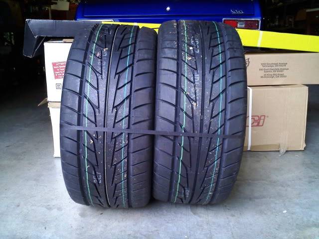

      What kind of tires did you order?

      NT555's, 245/40 and 275/40, got them for 644 shipped to my door, not too bad, by the time i wear them out i should have more money to spend on a better tire.

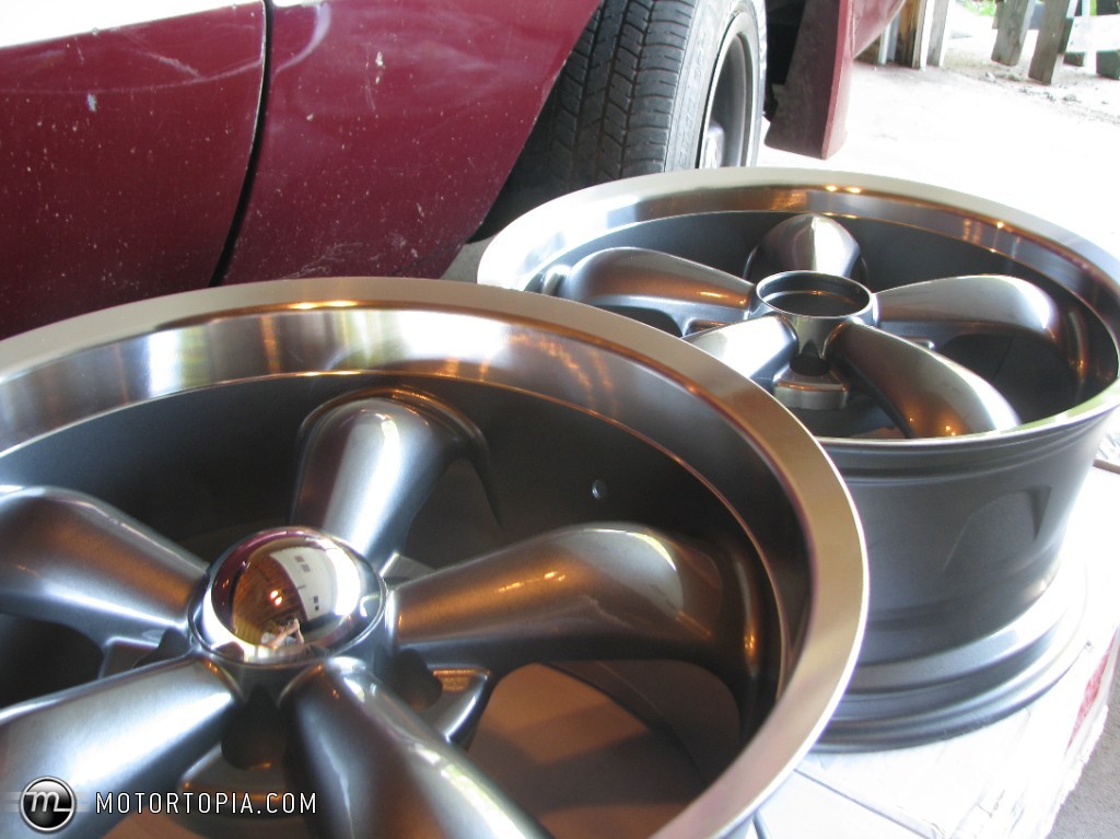

      Rear wheels
      Rear Tires
      Front Tires
      Jason Nichols

      Quote Originally Posted by Jasons72 View Post
      Good price, where'd you order them from?

      The lip does not change with backspacing, the backspacing is machined away from the backside of the mounting flange. And i can tell you no way will you clear with 5.5" of backspacing unless you plan on the tire sitting below the wheel well opening, in all honesty if i had more like 6 3/8" of backspacing i could fit a 10 inch wide wheel. A quarter inch more backspacing would have been perfectly centered in the wheel well. I'm taking the rears to have the tires mounted tomorrow so i will post a pic.

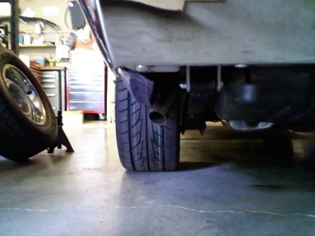

      Jason Nichols

      NICE, how is the space in the back?
      There was about 1" more lip on my 9.5s than the 8.5s, but I see in your pic it looks less than mine. That is weird.
      John, I have pics earlier in this thread. But motortopia (the hosting site) has been down a lot lately. Maybe you missed them.
