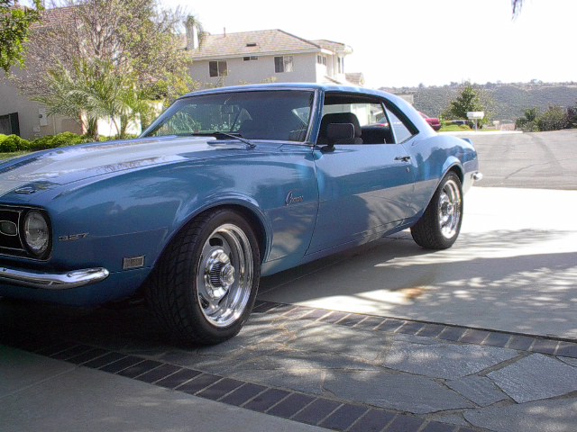

      I registered a while ago, but never posted pictures of my car. I have recently been upgrading/updating the front suspension and engine compartment and just got the car on the road again so I thought I would post some pictures. Next project is the rear suspension.

      Allen, the front end was just completely rebuilt. I used DSE control arms and DSE 2" drop springs, all new tie rods, idler arm, pitman arm, Bilstein shocks, Hotchkiss 1 1/8" hollow sway bar and rebuilt steering box from a 3rd generation Z-28. Also installed Baer 13" Track system which required new wheels and tires. The wheels are Wheel Vintique Billet Rallye 245/45/17 up front and 255/45/17 in back. I think I could have gone with 275s in back but I was concerned about rubbing and did not want to take any chances.
      Prior recent upgrades include PRC aluminum radiator with Spal electric fan, March Serpentine system and Covan's Classic Dash with Autometer gauges.
      Bill, I am assembling parts for the rear suspension upgrade which will include DSE dropped leaf springs, Global West subframe connectors, Bilstein Shocks and a new posi rear end.

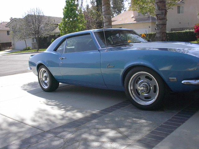

      Tony, here are a couple more shots. Let me know if you want any other views or need closer views, its no problem to go take some more shots.
      I spent a lot of time trying to find pictures of cars with those wheels, because I was not sure if I would be happy with them. I knew I liked the look of the 15" rallye wheels, but I was unsure of how the 17" size would look. You may remember receiving an e-mail a few months back asking you about your rendering which showed the Wheel Vintiques wheels. That was me trying to get more information on those wheels. Anyway, I am very happy with how the wheels look and glad that I decided to go with them.

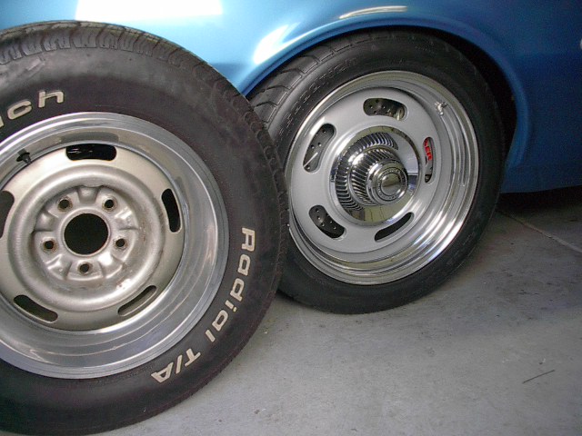

      Thanks Woody. They look great. How close would you say the powdercoating is to the original GM silver? Those look a little darker than the original color. Or maybe it's the shade that's doing it.

      Tony, I just looked at my old 15" rallye wheels and I don't know if the paint is the original GM silver, but the powdercoating on the 17" wheels is lighter and a solid color. It is fairly close but not an exact match. The 15" wheels seem to have a slight metallic finish and are a darker silver. If you like I can try to take a picture with the 15" wheels next to the new wheels.

      Ok Tony, here you go. After comparing more closely, I would say the powdercoat on the 17" wheel is more of a grey color and is not a very close match to the silver paint on the 15" wheel. I also notice that the slots in the 17" wheel are much larger than those in the 15" wheel. Hope this helps.

      Yeah...I guess I didn't notice the slots being bigger. Still, they look OK. I guess it would make sense for them to be bigger being that the wheel center is bigger. It looks good to me.
      If it bothers me enough I guess I could just scuff the powdercoat with a scotchbrite pad and then repaint it with a can of the original stuff from Classic Industries. Although it's gonna feel funny painting a $350 wheel.
