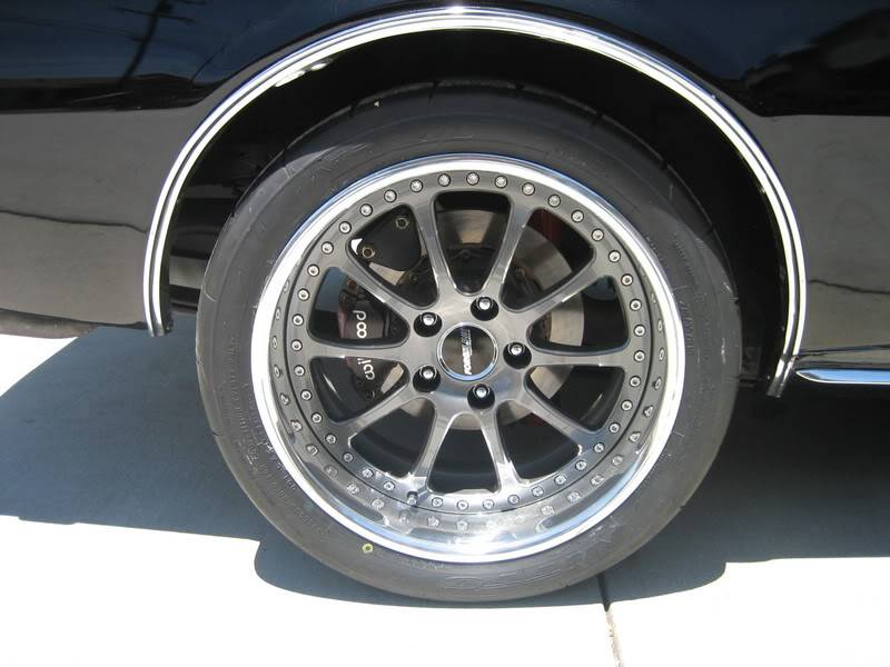

      Below is a couple pics of one of these we just did for a member here.
      Member thread is here

      Not the best picture, but this is about 3/4" per side narrowed...

      Good looking wheels. How do they look when the tires are mounted? Oh WAIT!!! Thats them right? The thin black line? I thought that was paint. Hahaha.. Kidding.. The wheels look good, nice deep lip on them. JR
