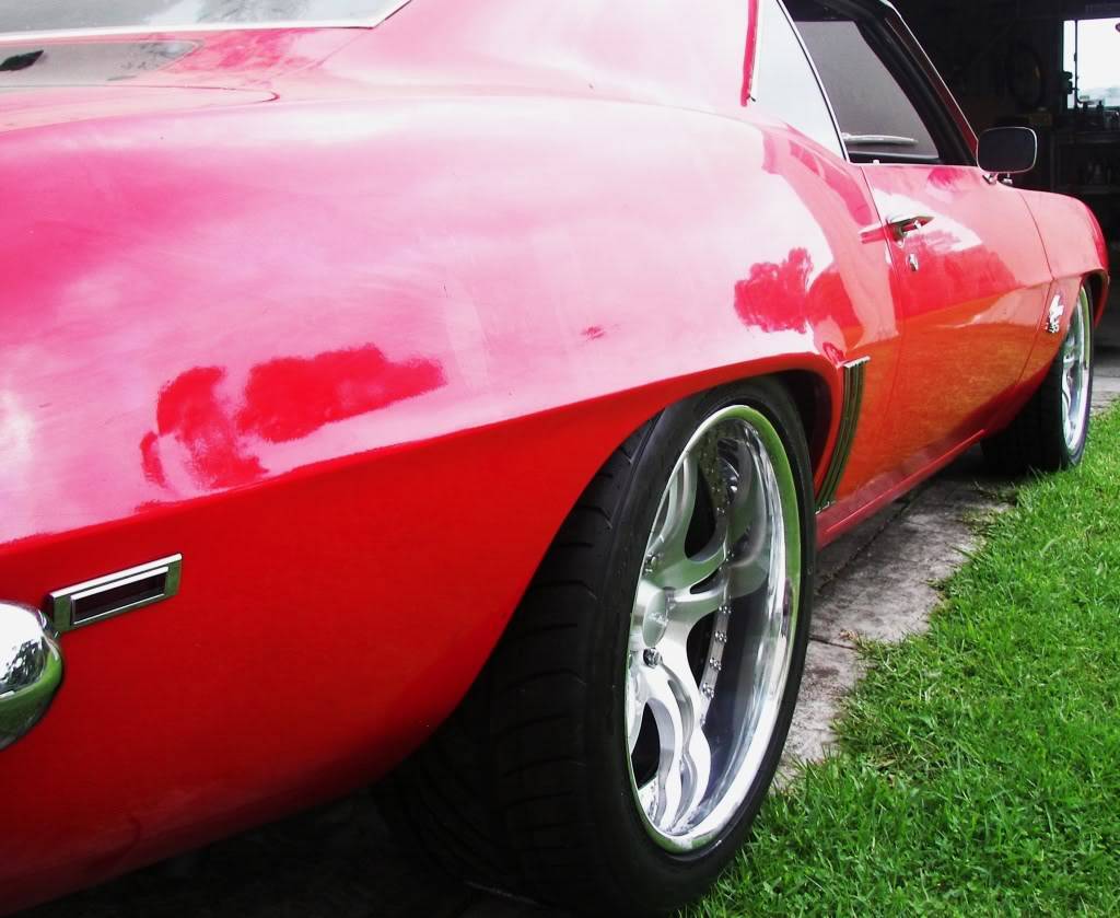

      Guys , i got my new rushforths on, 18x10 with 5.75 b/s.... i got big problems...the tires are sitting hard on the 'hump' just above the lip??? I have heaps of room on the inside where i coulda had a better b/s???????. The lip is trimmed up to miss the tire , but then above that it rubs hard on the hump up and in there...
      diff is moser 12 bolt /drum brakes. Pretty dissapointing...

      A buddy had that problem and he was able to have his rim trimmed on the inside, it worked for him but not forsure if I would have do that.
      827
      Gavin, That backspace should clear all day long and is what we always do for 69 Camaros so it should definitely fit in there. Are you running 275/40s?
      These are 40+ year old cars where all kinds of things happen to them along the way, let alone somebody on the assembly line on Friday in a hurry to get to happy hour but that wheel should fit in there. Could your Moser be on the wide side?

      Like Jay said, what's your WMS-WMS measurement on your axle housing? Typically disc conversions in the rear will move the wheels out another 1/16" to3/16" or so depending on the kit, so be sure to factor that into the solution...whatever that ends up being.
      Fitment issues aside, your car looks damn nice with the new shoes IMHO. Good luck tracking down the source of the problem and finding the best solution.

      Agree with Jay & Tobin,that b/s should fit all day long....gotta be the rearend.
      I run the same 18x10 Superspokes you have with 5.625" b/s and I have no issues,standard GM 12-bolt.I could actually run 1/4" spacers (sometimes I do) to pull them out a bit further.

      Jason Rushforth and I was discussing this the other day. We always do 6.0 BS. 5.5 on a 9.5 puts the other profile of the tire at the maximum , only extra room with a 10 is to the inside. The outer wheels house hum is more of a interference that the lip on orginal quarters.
      If safe mat, anyone doing any rim size can deduct 4" from the rim size (not the overall width), but the actual rim size, and get the correct B as you always have to protect the outer wheel profile with the panel.
      So if doing a
      8" Wheel, 4" BS
      9" Wheel, 5" BS
      9.5" Wheel, 5.5" BS
      10" Wheel, 6" BS

      IS that a new rear? is it 60.5?
      australia
      64
      thanx guys for the advice... the rear is one of moser 'crate' rears they list..complete with brakes etc. are these diffs the same width? i thought they were .
      todays update is - i tried to beat that damn hump under there and cracked the paint on the guard well and good. so now i will get a new rear quarter fitted and 'tweak' it while its off if thats at all possible. It did need doing down the track , but circumstances have changed

      Do you think if i replace the rear quarter and outer wheelhouse it can be tweaked to tuck the tire better?. By some kinda modification? This is where im at.. I think because its had a bingle and repair previosly in that quarter its maybe not to factory spec and not in original position...thats my guess.

      You need to measure that rear and see how much more you can go inboard. You said you have lots of room. As well you should. The extra 1/4" would make a real difference.
      Wat size are the tires?

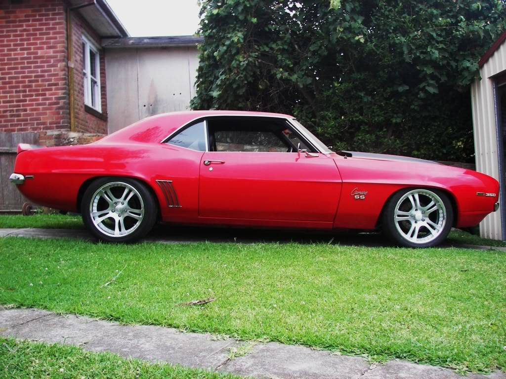

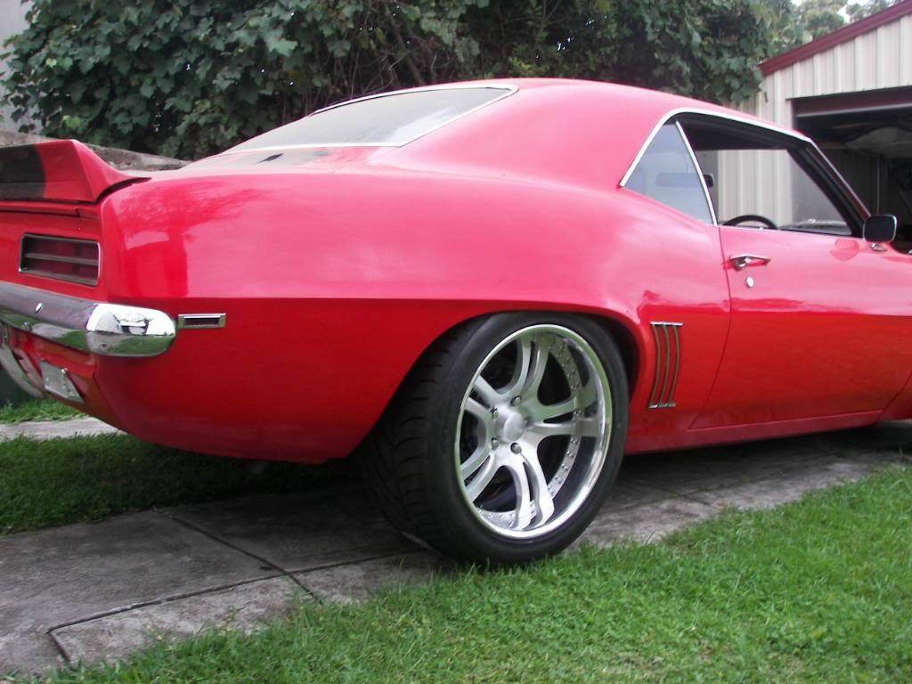

      Thanx Nick, heres a cupla other shots of my car... my wheel sizes are 18 x 10 with 275/40/18 nitto on rear. 5.75 b/s. ..Gav

      Another option is to find a local machine shop with a mill. Remove the tires from the wheels, and have them mill off some more on the backside of that mounting pad. That is, if you have enough meat back there to allow the conical seats still have some material left under them. Post a pic of the backside of the lug pad, looking into a lug hole. We could look and see if it could be machined further.
      Also note your brake caliper clearance before doing any machining. As you mill that pad, the caliper gets closer to the spokes.

      60.5 WITH brake drum. 60: flange to flange.
      My bet it the rear is right.

      thanx Nineball, i got drums back there... I did have a look at this yesterday and i probably could get away with a little off the back pad. I will fix the rear quarter first and see if i can get things back to square 1 ..I think it all comes from a repair from previous owner ..The panel was not pushed out to the factory position ..I can see hammer marks up in wheel house area.
