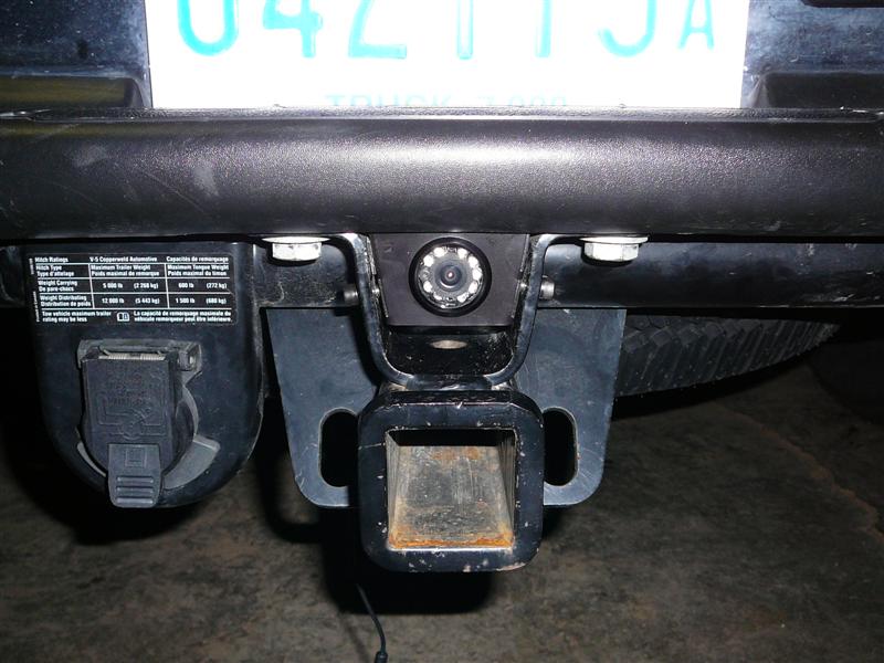

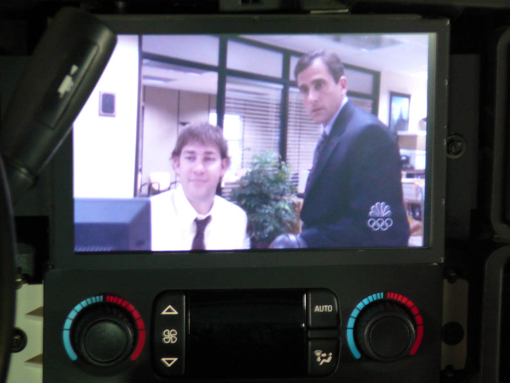

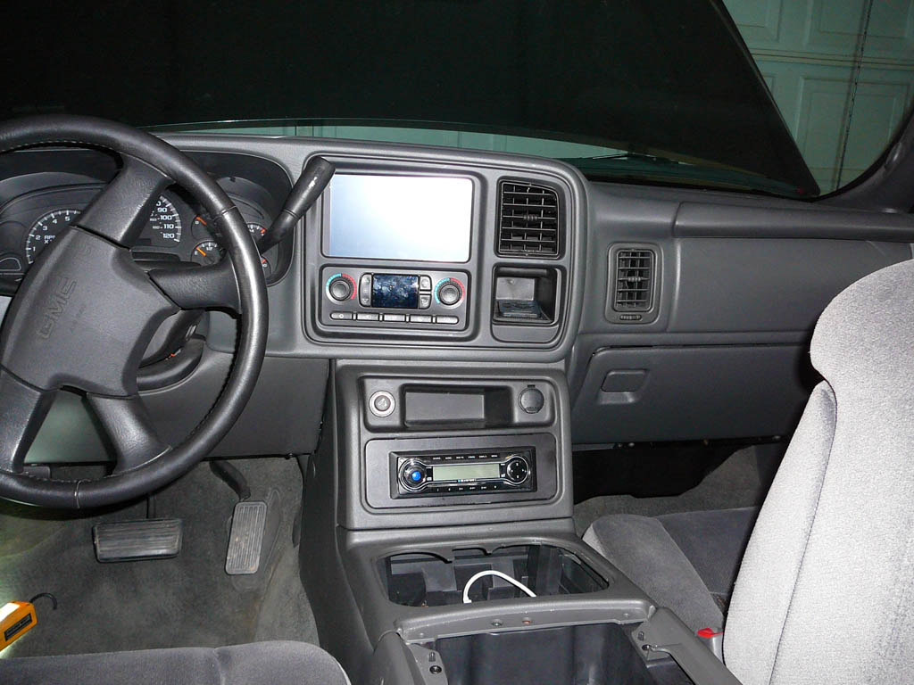

      I have an electrical engineer buddy that I helped put a PC in his '05 crew cab 1500 Chevy. He lasered out a custom case for a small form factor MoBo - Mini-ITX or maybe Micro ATX. I can't remember.
      I'll find the pics and videos of it and post them. He has a touchscreen in dash that replaced the double DIN radio, GPS antenna built in, WiFi, cell phone wireless interenet connection, automatically switching backup camera in his hitch for hooking up his boat trailer. It came out really nice. He runs it through a single DIN head unit for sound amplification and then to a couple of amps.
      He is running a GUI (it was free and could be customized) for the main interface, but it is running XP. I think he may be going to rebuild it with the OS on a solid state drive so that it boots quicker.

      Here are just a few quick pics of his setup - Not a Mac, but........
      The dash is back together, but the console isn't. He mounted the PC under the rear seat and ran all of the cords through the middle/console area. He mounted a slot load DVD in the back of the console too, which was nice for playing DVD etc.
