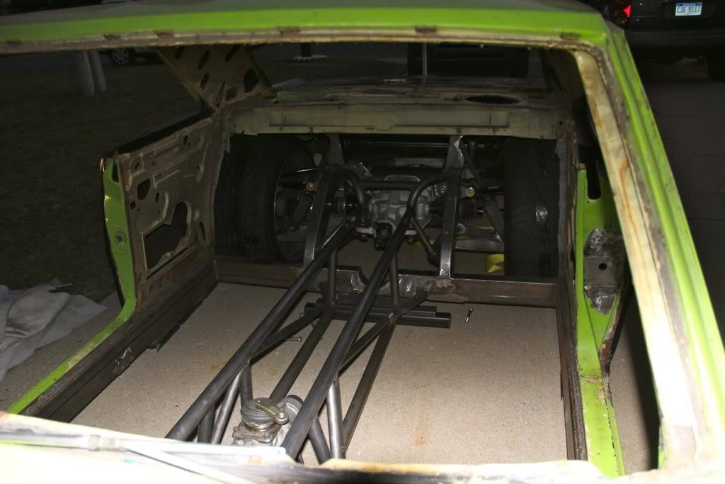

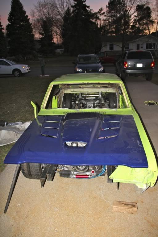

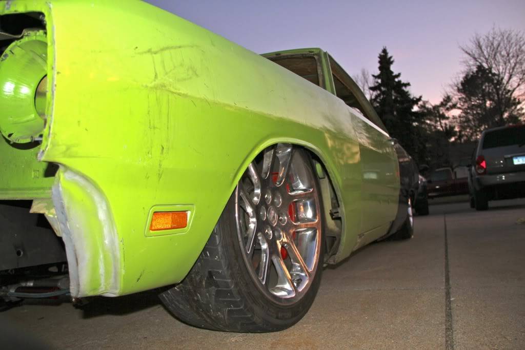

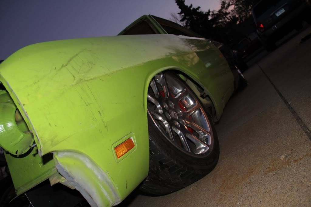

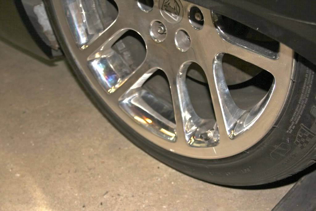

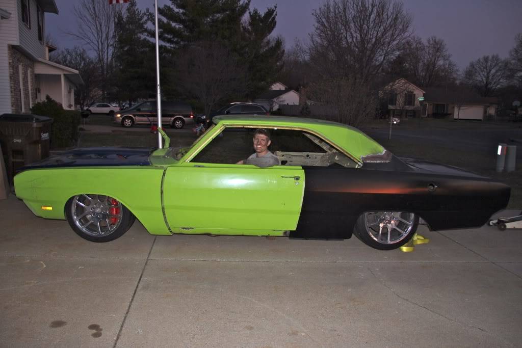

      So where did I leave off? Yes, front's done, rear's done, back-brace is done, still need to do the front down bars and finish the core support in order to hang the fenders and stuff. Then it's off to body-work. Yes it does ride a bit low, 5" from the ground to the frame; but I've seen others at this height and they seem to be all good. The quarters are not welded in yet and the pinch rail flange has not been cut off so that makes the rear look a bit lower. A lot more to do before it's ready for the body shop, but should be able to get all that done, and then some, the next two weeks I have at Christmas. All in all, I'm real happy with where I'm at on the project. I couldn't have done it without the help of some great guys, Dave, Jeff (droptop73), and Greg (ChopSmitty). All their assistance, big or little, has helped me get this far. Still a few issues to resolve but nothing that will be too ridiculous.I'm already looking forward to the next trip, 9 months from now...
      Not the best pics of the back-brace, but you get the idea.

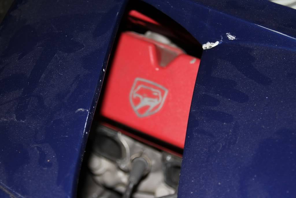

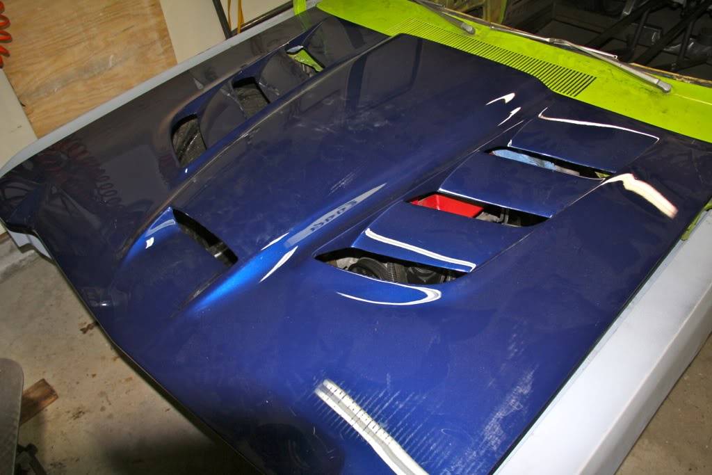

      The hood, man this thing is freaking AWESOME!!! (fenders and hood to resting in place, more or less) BMW Interlagos Blue, sustained some shipping damage but just small stuff.

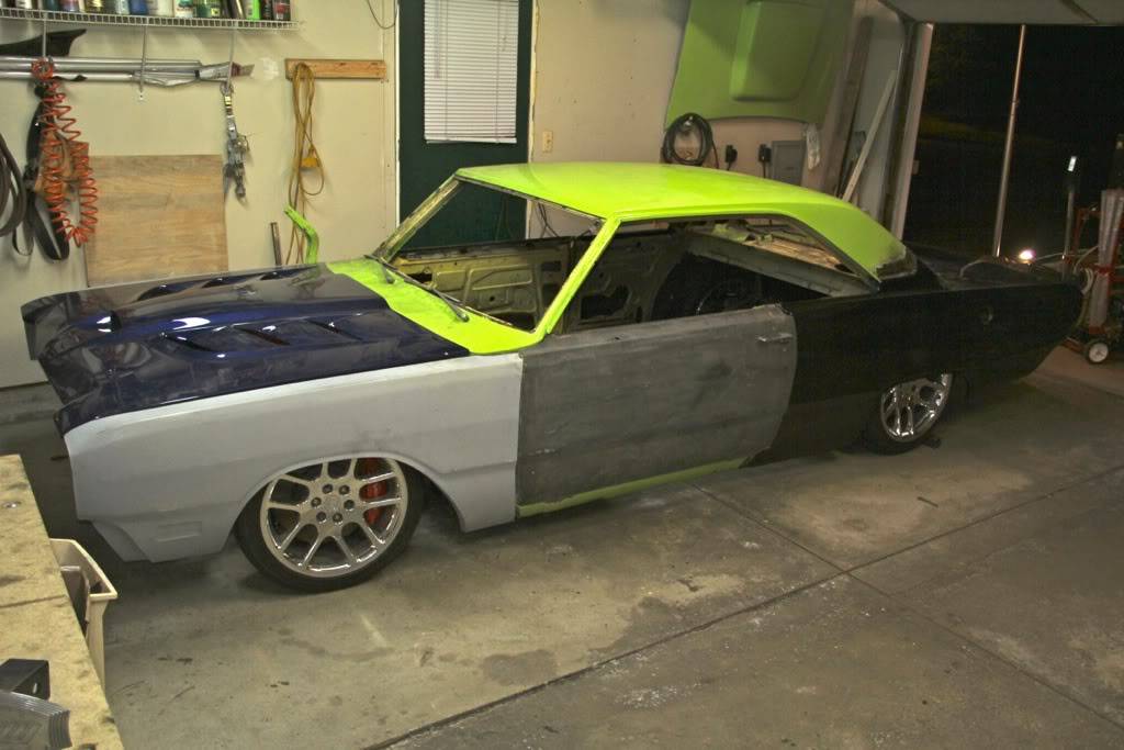

      And a few fun money shots, just for fun
      After rolling it back in the garage with the new doors ('74 doors w/ no wing window, hate those things), 'glass fenders & trunk lid

      What are the plans for the hood? Are you living it the way it is or are you going to put some grill work in the openings?
      That hood is so cool!
