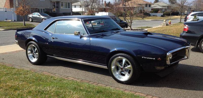

      somebody over on the PY forums posted up this picture
      http://s932.photobucket.com/user/72b...c23e4.jpg.html
      That is awesome!! Looks like the Year One setup? I gotta get moving on that paint,lol. Thanks for posting that pic, it'll be my new inspiration

      Quote Originally Posted by 67rstbkt View Post
      yea those are the Year Ones, but I dont know, something just doesnt look right on those wheels, I like the US Mag Bandit way better

      Quote Originally Posted by captainofiron View Post
      That is sweet! I think those wheels look perfect on there! Only thing I would change on that car is the hoodscoop...
