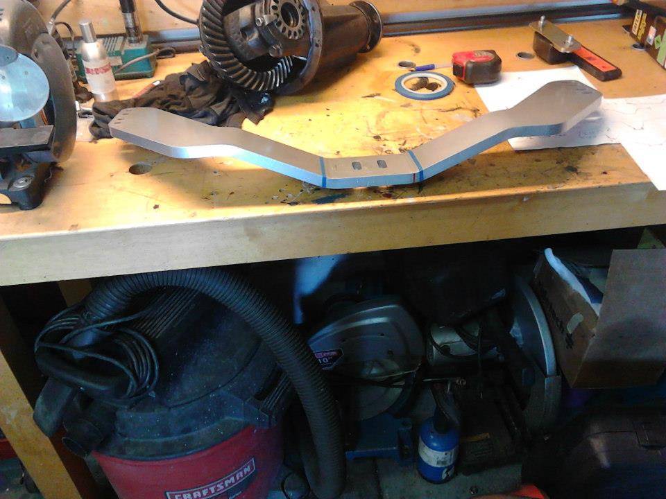

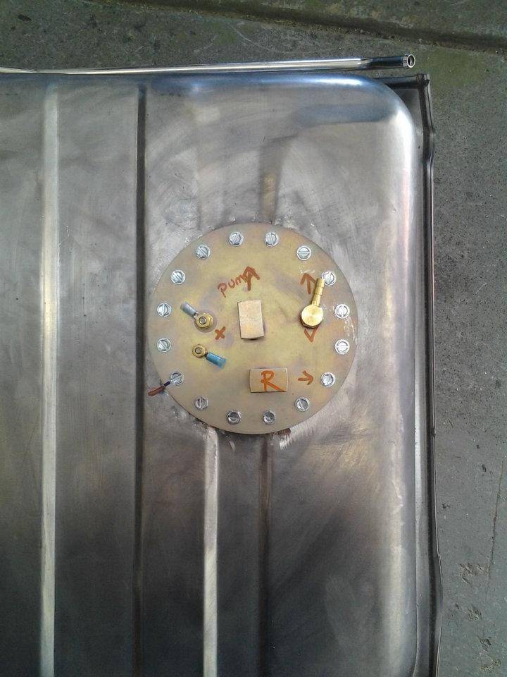

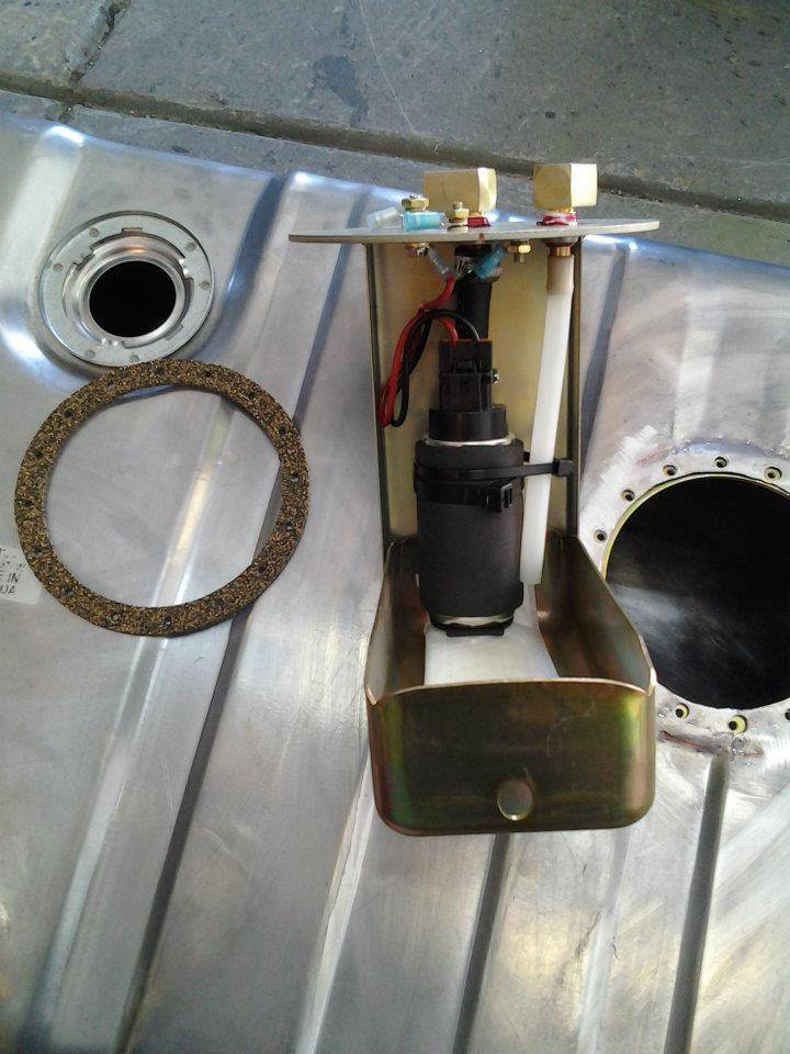

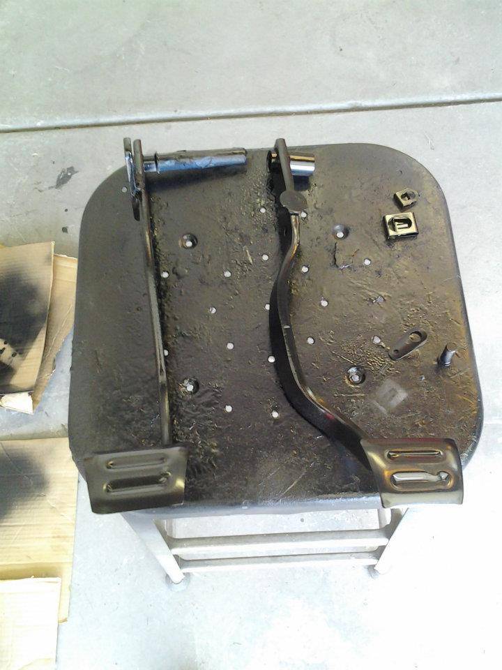

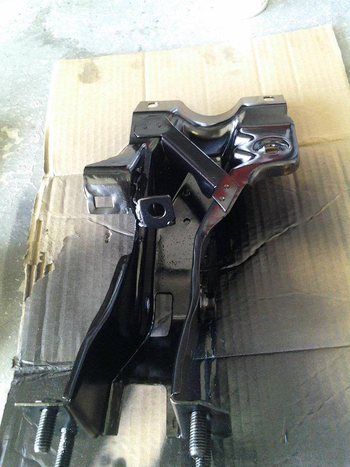

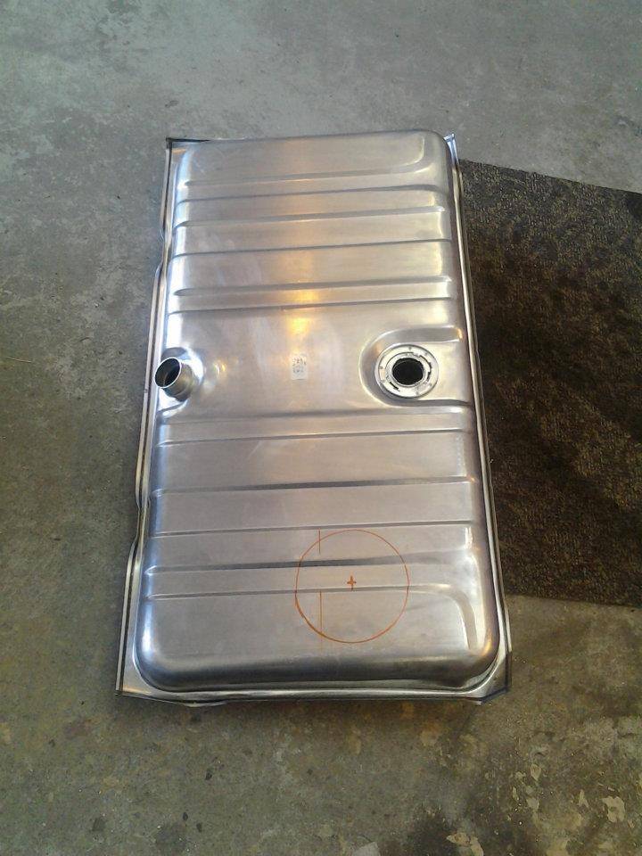

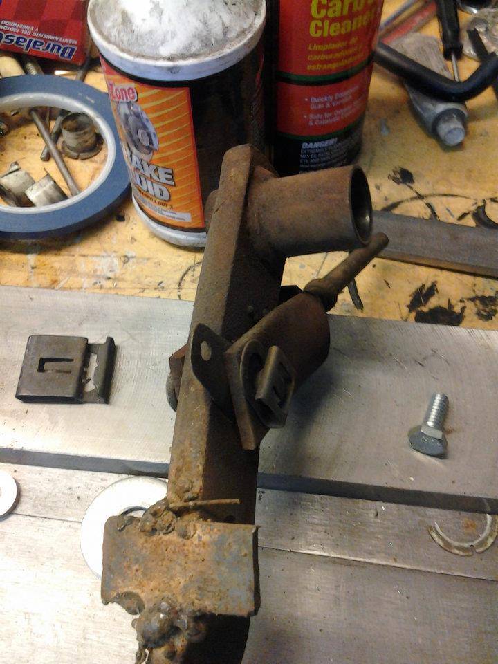

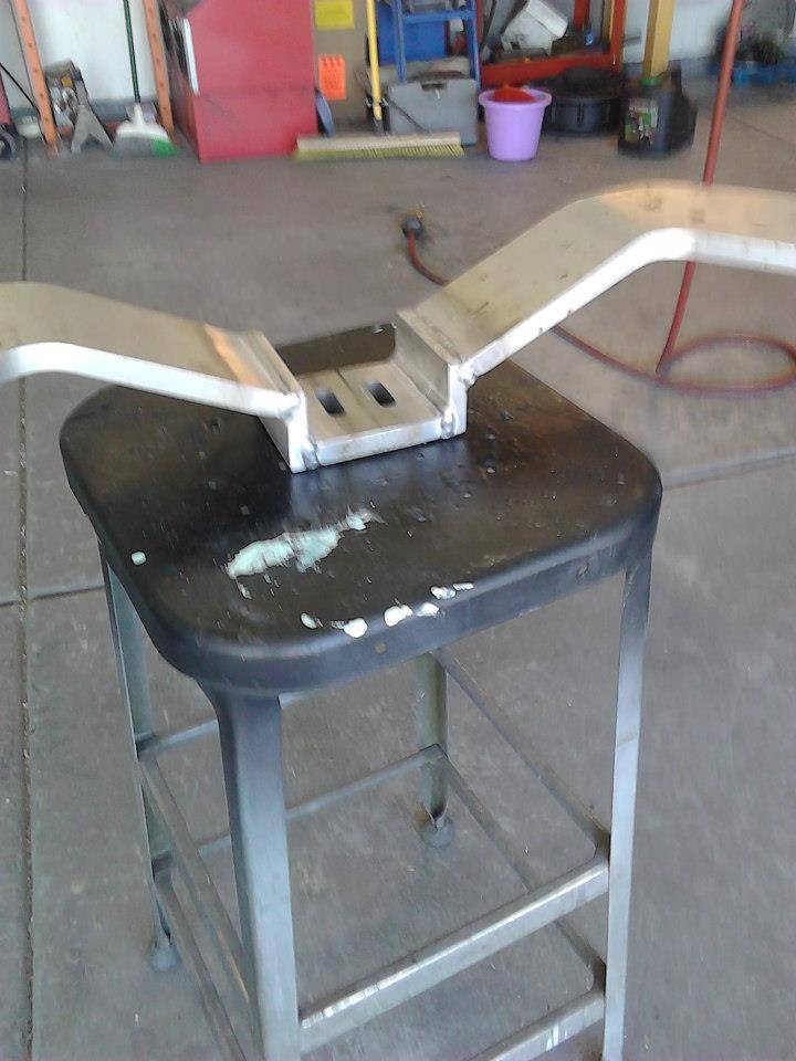

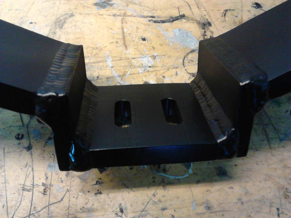

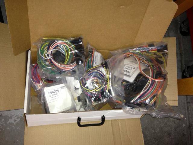

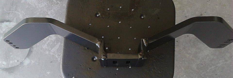

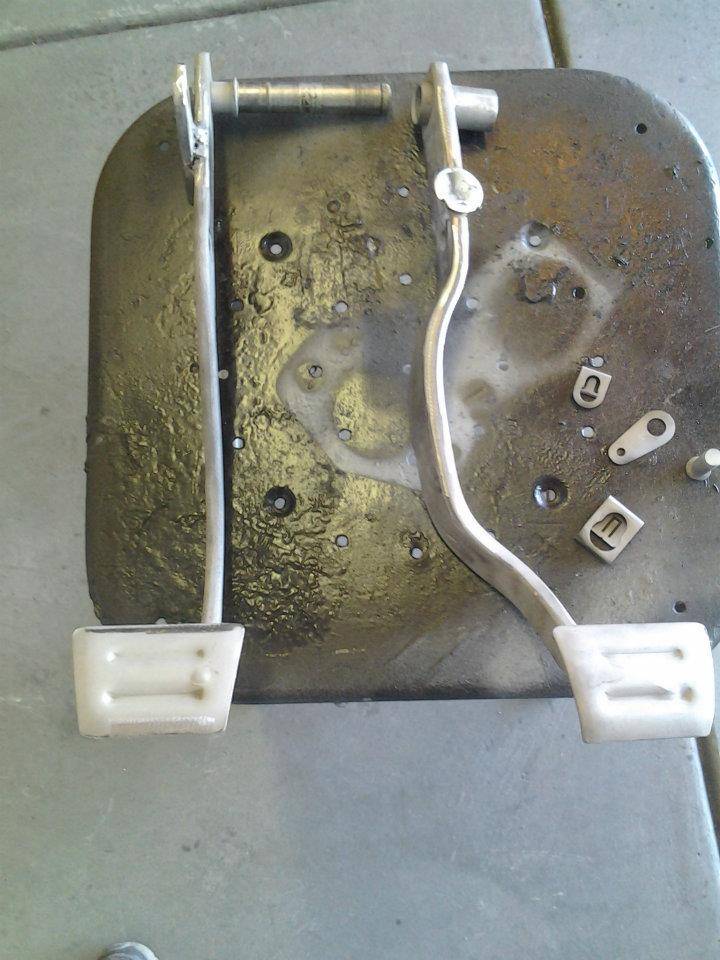

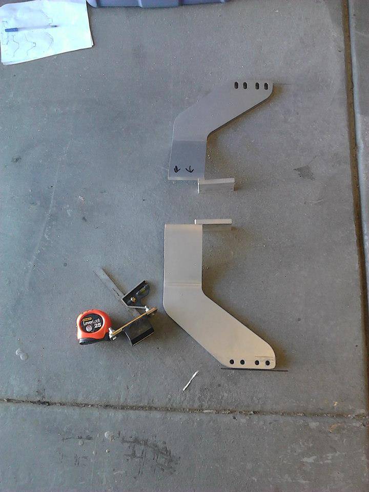

      Long overdue for an update so here we go:
      Fuel system: complete (used a Tanksinc pump setup, ROBBMC regulator, 3/8 stainless feed and return
      AAW wire harness, installation underway
      Pedals refurbished, modified to work with new clutch, and old butchery welds cleaned up
      Lincoln Mark VIII fan installed
      Bought an American Powertrain x-member that was supposed to fit.....of course it did not, so had to modify to make it work
      Ordered a ridetech 4 link and coil-overs, waiting on getting the wheels and then I'm going to attempt to narrow the Ford 9" I have in waiting.
      I've also been continuing to work on the body and will be attempting an initial start of the motor real soon to get the cam broken in and make sure nothing leaks :excited:
      On to the pics:

      what did you think of the tanks inc setup? looks like my best solution for me EFI conversion for the duster.
      how was install? anything you didnt like? how high does it stick up from the tank surface? anything you wish you could change?
      ad i just got done reading all 4 pages. currentyly doing a partial reesto on a 68 myself.
      For the money, I don't think it can be beat. I went with the Walbro 255lph pump (high pressure) and a RobbMC regulator to get it down to the right psi for my carb. If I ever do go fuel injection, I should be able to swap the spring in the regulator and call it good. If you do get it, plan it out carefully for the best spot. I measured a few times before cutting my hole. Also, the top of it and the lines take up a lot of space (I would have to measure, but somewhere in the 1-1.5" range). I ended up cutting a hole in my trunk floor to clear it. I don't mind it so much because I will be able to access the pump without dropping the tank. Cutting the tank and welding in a recess could also work if you do not want to cut out an access panel.

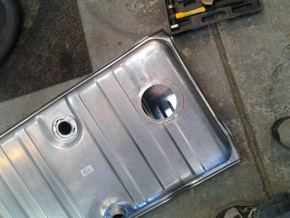

      Took some pictures of the trunk area and a measurement. From the gas tank surface up to the top of the fittings it's about 1 3/8"
      I cut a hole in my trunk and made a raised section to hold a cover panel.

      Little update on the Tanks setup. Turns out my placement is not the greatest. I got the motor fired up and it started starving for fuel after about ten minutes (added 4 gallons to the tank). I will have to rethink the direction of the sump or possibly cut a section out below and add a sump into my tank.

      Got the motor started for the first time. Found 2 issues:
      1: I will need to rethink the fuel pump setup (see previous post)
      so what do you think is going wrong? and could it be size of tank vs amount of fuel problem?
      i saw yu ut it in the left front corner, with the hole facing the slope (assumed)could the slope be partally blocking opff the hole?
      The instructions said to place it sideways in the tank, so that's how it is right now. It might work better if I have the hole in the sump facing the front of the car, so I may try that first. The other issue is that the bottom of a tank is not exactly flat, so getting a flat piece to sit flush won't work. I thought about placement for awhile before I cut the hole and figured that where it is would be the best spot (it's pretty close to where the factory places the pickup). This part of the project will probably be put on hold while I work on other stuff, but I'm confident I can get it working better. If spinning the pump does not work, then here's what I'm thinking:
      1: Try modifying the sump to fit the bottom of the tank better; cut bottom out, maybe add a new section to match slope of the tank, or
      2: Remove tank, cut a hole in the bottom and weld in a small sump section for the fuel pump to sit in. If I went this route, I might see about adding some additional baffling to it.
      As a side note, the pump seems pretty loud, but I'm guessing that may be partly due to no insulation in the car right now.
      You should check out the new products section on Tanks website, they have a bunch of stuff now that would have been great when I got mine. They offer a factory fit fuel tank for my application, already baffled and with a recessed section to clear the fuel lines for $210
      They also have a weld in drop piece to provide room on an existing tank.
