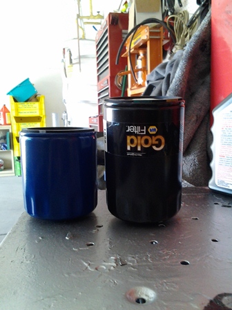

      Quote Originally Posted by CliffS View Post
      You're the man!! Curious about fitment!
      No problem, here it is. The Napa filter is about the same diameter as the AC Delco, it's just longer. It does fit, but it was harder to get it in there. Once I got a few threads turned, piece of cake. Here are the pics; I have one of each filter on the car and one pic of the two filters next to each other.
      Joe M
      '67 Firebird
      My build thread: https://www.pro-touring.com/showthre...irth&highlight=
    4. #104
      Amsterdam,The Netherlands
      880
      Country Flag: Netherlands
      Quote Originally Posted by 67rstbkt View Post
      Thanks a million Joe. That extra filter will do the trick.
      It seems you have more clearance with the 568's. A buddy locally here runs a BMW shop. He was able to track down a WIX 51522 (Miracles happen). I will spend some time wrenching next Sunday.
      Anytime; thanks for the tip on the filter, I like this option better. I would have thought you would have more clearance with the 569's. I'd be interested in seeing what it looks like on your setup. If I can find any more info on it, I'll let you know. There's got to be a cross reference somewhere.
      Better safe then sorry. Small investment on the filter. I will shoot some pics Sunday. Thanks
      That's for sure. I found an applications listing on Napa's website. Looks like the 1522 fits a lot of different applications. I've already found a bosch and K&N that looks like it would work. Here are the applications from Napa's website:

      Hey Joe, update.
      The 51522 delivered:
      A lot smaller, but it seems there is a big difference between the round port and d port headers.
      The Napa I used before
      and the WIX
      I had to put the WIX on the filter adapter before mounting the filter adapter, otherwise there was no way to get the filter on the block. One mounted the filter bottom just hits
      the header. It's so little I was able to twist the filter and hand tighted it. I think I'm going to leave it this way for now, to much of a headache.
      Hey Joe, update.
      Wow, it's crazy how much different it is in your setup. If I had the same fitment, I might try the offset adapter R.A.R.E sells for their ram air manifolds (Maybe tilting it back will make it easier to get in), or just do it like LeighP did.
      Crazy indeed! Turns me crazy but it is part of hot rodding I suppose. Any idea what anlgle the R.A.R.E adapter makes?
