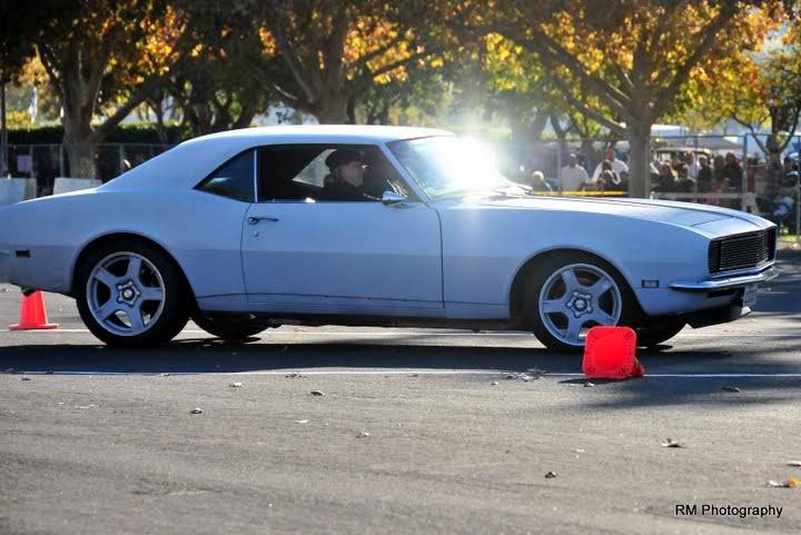

      I'm a newbie here and Currently building a 1968 Camaro with a few additions, I'm here to get a little tuning advice and pass on some of the same
      Suspension & Brakes;
      Hotchkis 2" Front coils
      Hotchkis 1.5" Rear Leafs
      Hotchkis 1-1/8", Hollow Sway bar (front)
      Hotchkis Machined Tie Rod Sleeves
      Hotchkis Sub Frame Connectors
      Hotchkis Rear Shock Tower Brace
      Hotchkis Chassis Max Handle Bars
      Hotchkis Premium Steering Rebuild Kit
      Complete welding of all seams on the factory sub-frame (for strength) and then Glass shot peened to reduce torsional chassis stresses (Peen-Rite)
      Global West aluminum body mounts and stainless sub frame bolts
      Global West 6 degree Upper tube arms (Urethane bushings)
      Ceramic Painted stock lower Arms with (urethane bushings)
      KYB Gr-2 shocks front and rear
      AGR 12.7:1 gear ratio Billet power steering box
      Derale Power Steering Fluid Cooler
      Magnefine Inline power steering Filter
      SSBC drum to power disc conversion 4 wheel brake Kit
      Hawk Performance's HP Plus disc brake pads
      Corvette C5 wheels 17” front (2”spacer)18” rear (2.250” spacer)
      Engine;
      Seasoned, GM 350 engine Bored 30 over and surface Decked (010 4 bolt block)
      ARP Main Bolts
      ARP 134-7901 Oil Pump Driveshaft
      Melling M55HV (high volume) pumpwith matching pick up tube for oil pan
      GM heads Surfaced with 1.6 rocker arms
      Victor Reinz performance gasket's
      Holley Street Dominator intake
      Edelbrook 1406 carb
      Moroso Carburetor Spacer 1”
      Holley Red Electric fuel pump
      3/8" Stainless Steel Front to rear fuel line
      1 5/8 in. Headers
      Safety wired header bolts
      2.5” Mandrel bent Aluminized Exhaust Front to rear with H Crossover
      HITACHI Mini Starter (high torque)
      Mallory Unilite distributor
      Msd coil
      Taylor 8.8 plug wire set
      Prothane's poly urethane engine mounts and ARP engine mount bolts
      ARP stainless engine complete bolt kit
      Taylor spark plug wire holders
      69 Camaro 4 Row Radiator
      Aluminum over flow bottle
      16” Electric cooling fan and aluminum fan shroud
      Royal Purple Oil
      Power train;
      Richmond Super T-10 is a four speed (1st gear is 3.42, 2nd is 2.28, 3rd is 1.46, and 4th is 1 )
      Prothane 7-1604 transmission mount
      Red Line Trans fluid
      621 bell housing
      Zoom clutch
      Centerforce Flywheel 168 tooth
      ARP Chevy Flywheel Bolts
      Hurst/Indy 4-Speed Shifter (7 1/2” tall shift arm)
      Lakewood shift fork
      Lakewood pilot bearing
      Stock balanced Drive shaft with Currie Enterprises U-Joints
      Factory 8.2 10bolt (3.08 ratio)
      Trunk Mounted optima battery and NoCal Speed Shop Battery Mount
      Interior and Exterior;
      Scat Pro Car seats
      Aircraft style seat belts
      Talbot Vintage racing mirrors
      Detroit Speed and Engineering 7 speed wiper kit
      Detroit Speed and Engineering 68 RS electric headlight Door update kit
      Billet RS grill kit
      Tri-Bar Halogen headlights
      LED front turn signals
      Air Rides billet fuel cap systems
      American Autowire Kit Classic update full car harness kit
      Auto Gauge instruments
      Cool IT thermo tec insulation
      Southern rods hot rod heater (smoothed firewall) with custom single switch control
      Grant GT steering wheel
