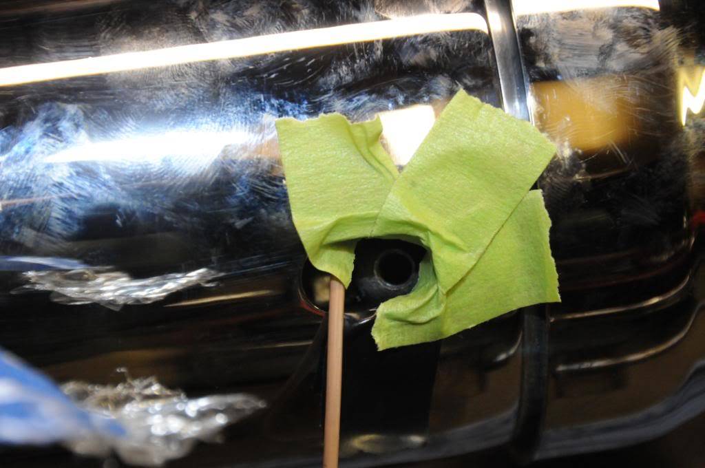

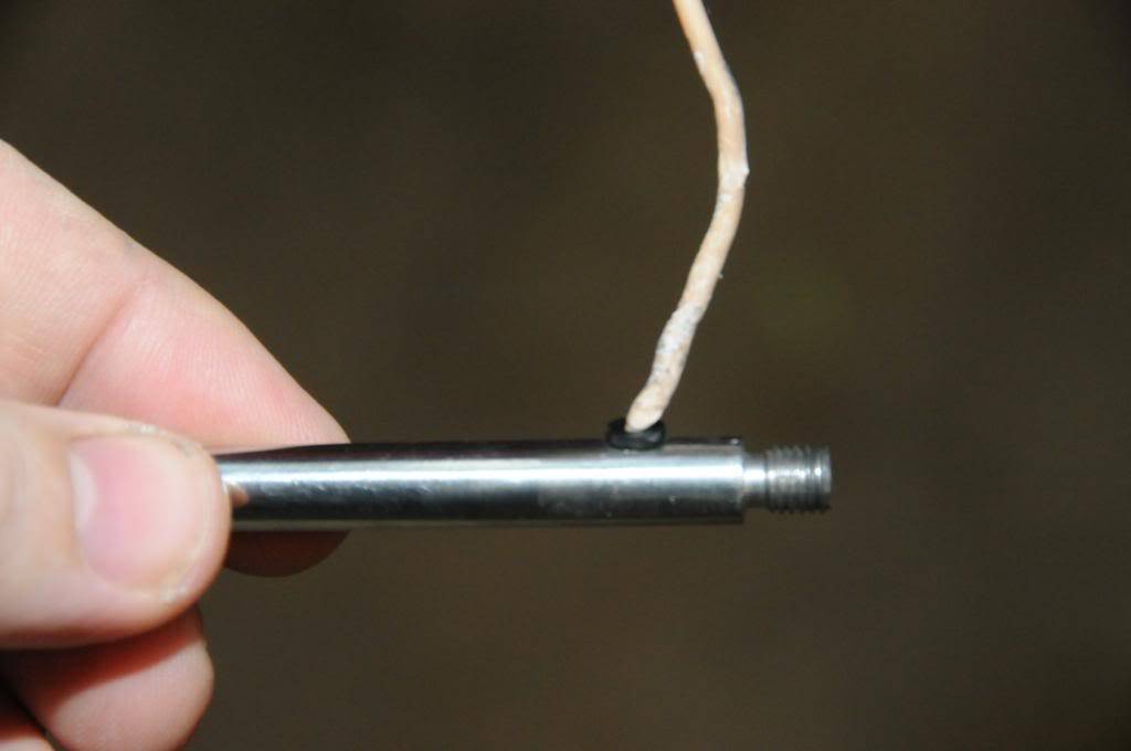

      OK, gave up on the TL-1. Even with the second switch, it was obvious that the clearance just wasn't enough for me to be comfortable considering it would be a line lock. Imagine if the insulation got frayed as I'm going into a turn hitting the brakes and the circuit grounded, engaging the line lock!
      Here are some pics of the situation.
      This shows the way the wire comes out of the lever at a 90 degree - about exactly where the column housing would be....
      This shows how little clearance there is on the column
      And here we see how the wire holds up when in position...
      The item is "almost" correct. The wire should exit the lever through a channel at 45 degrees or less, eliminating the entire issue. Perhaps on columns other than Ididit there is a larger opening for the tilt lever. Dunno. I just know I won't put an entire build at risk with this. Just thought others may be interested. There is little (translate to absolutely no) information available concerning this item.
