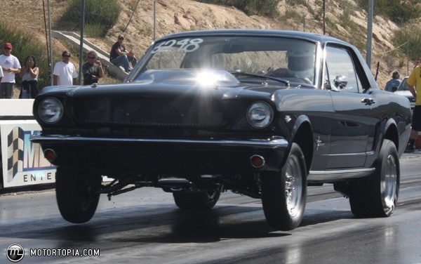

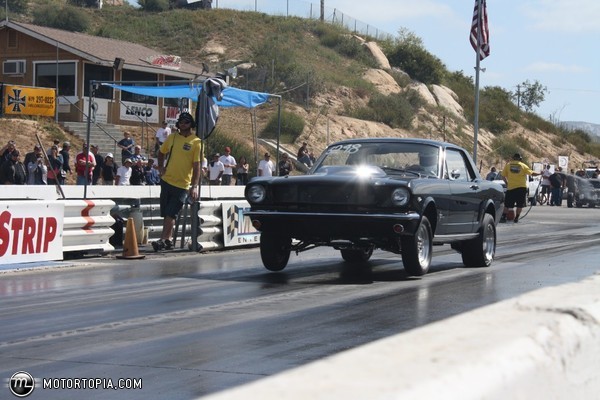

      finally some pics in action. Yep pulled the front wheels off the ground and this is with a 300 horsepower spare motor we built.
      1.77 60' times
      8.40 in the 1/8 mile.

      wow, that thing HOOKS!
      Running Caltracs?
    9. #49
      san diego
      5,101
      Yep, I was there yesterday with the mustang. Did you see it?
      No caltracs. Im running slapper bars and some secret mods to the springs. But i really think its the trick front suspension i designed that really allows the weight transfer.
