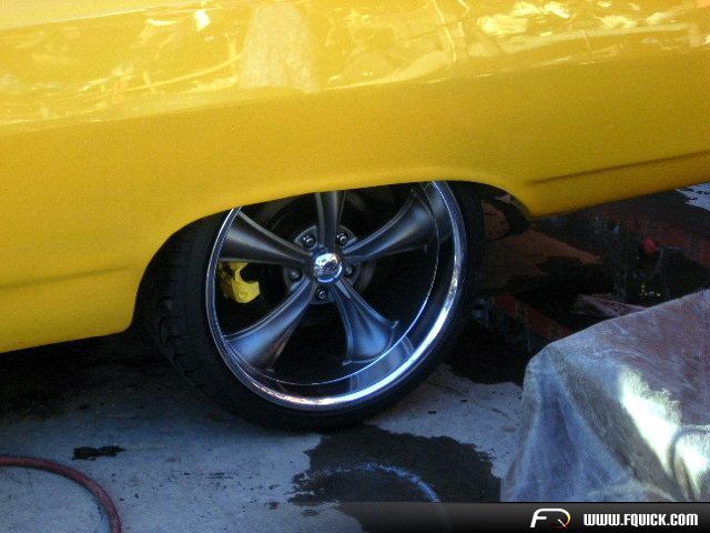

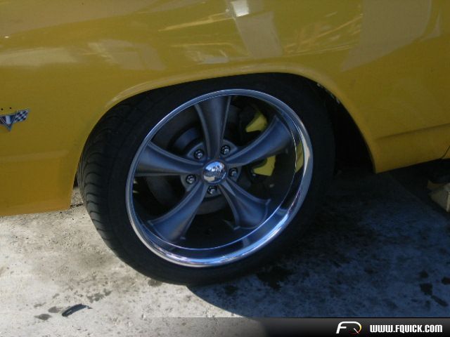

      I am running Boss 338 wheels in sizes 18x8 and 20x10.
      sorry the wheel well pics are not the best because of the poor lighting and camera but I hope you get the idea.

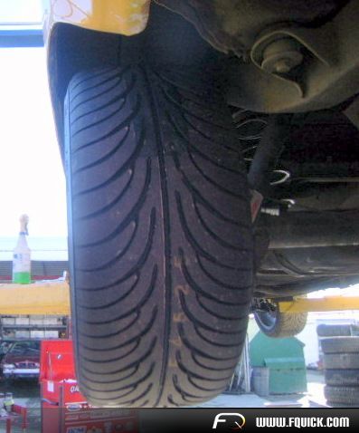

      Left rear tire:

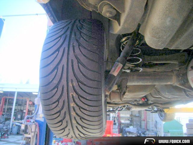

      It is a little tight on the outside but I am waiting for my UMI rear control arms to come in and I can center the whole rear end. On the right side the wheel is closer to the inside of the well. So centering should do the trick and give me plenty of room. Right now I can move the rear of the car without hearing it scrape on the body.

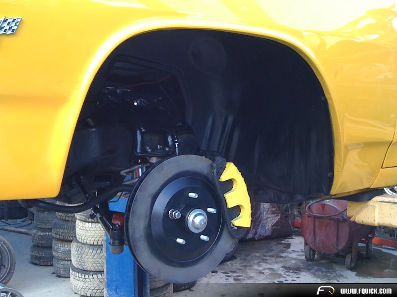

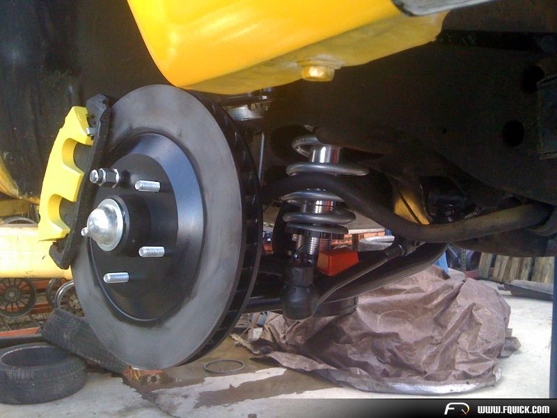

      Here are pics of the complete brakes and suspension work. I just need to decide on sway bar and the front is 100% done.
      For the rear I still have to hook up and make the rear brake line. Then decide on what shocks I will use.

      What control arms are those? Also, how is the fitment of the Boss 338 with those brakes? Are they very close, did you have to shave the 'corvette' lettering?

      thanks.....the control arms are Global west. The only brand I will use on any of my projects.
      No fitment issues at all on the brakes. They are close but do not rub on the wheel at all.
      I did not have to shave them. These had no lettering on them at all.I have access thru my work to buy PBR calipers. Those calipers were brand NEW with the pads, hardware, abutments(caliper carrier), and bolts. I could not buy used calipers and put them together for the same price I got these brand NEW calipers. Bonus was no Corvette LOGO. I did have to bead blast them because they have some type of grey coating on them that did not allow the caliper paint to hold.
