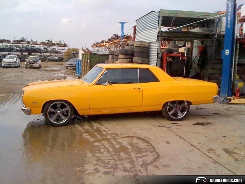

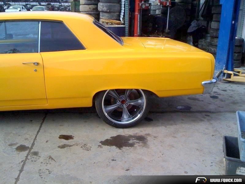

      Well it has been a couple weeks since i had time to work on the Chevelle. Just bought a new house and been moving. I finally got a house with some acreage so I can build my own shop.
      If everyone remembers I was having some wheel offset issue with the BOSS 338 wheels I had on the car. They were a 18x9.5 and were rubbing like crazy. Well I rolled the dice and ordered one of the 20x10 wheels in a 20mm offset and it fits.
      I even like the way it fills the wheel well up in comparison to the 18" inch wheel. I would of rather had the 18" wheel but BOSS Motorsports just not give you a lot of option when it comes to wheel offset. Now for anyone else who wants to try this you absolutely must roll the lip in as tight as you can. This one is section cut and was flattened prior to painting.
      I am going to lower the rear a bit more to take out some of the rake and level it out a bit.

    16. #36
      Fort Worth, Tx
      581
      Cool. If you can, could we get pictures of how the fit is inside the wheel well? Just curious how a 10" wide wheel will fit under the rear and ultimately how much this limits how low you can get. Prior to now, I've only read of maybe two other 65's using a 10" wide wheel without modifying the rear and wheel wells.

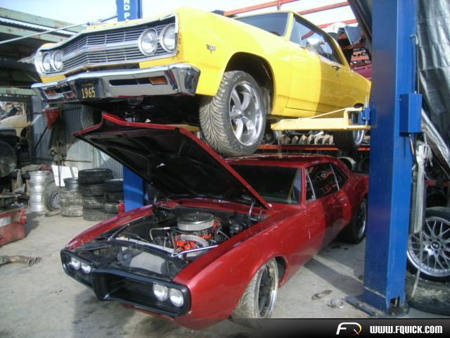

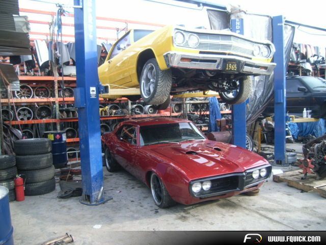

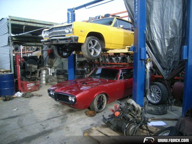

      My son-in-law was working on his 1967 Firebird and took a couple pics of our cars together.
