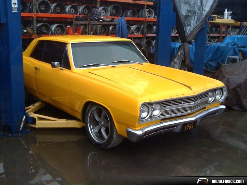

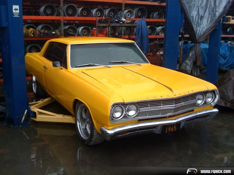

      Well on this very rainy day here in Sacramento so I could not get much done. I have spent the last couple weekends putting the suspension and engine/trans together and got around to doing some adjusting on it today.
      After playing with it I am not happy with the front setup. The coilover are adjusted all the way. I think I will need to get heavier springs or maybe tall ones. I might also try putting a spacer on the top of the front coils.
      When to the back suspension and had similar issues. It is just to rainy to keep messing with it. I like the way it sits but the rear wheel are rubbing. I will probably have to change the wheels and move them in a inch or more. These wheels were originally meant for my Camaro Project but decided to go a different route on wheels for the Camaro. So they were laying around so I decided to try them out. I will probably have to order wheel that have the proper offset.

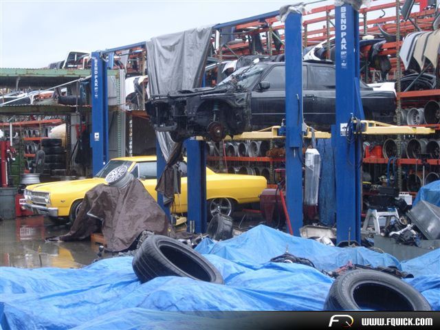

      Here is one with the car sitting next to my other project car.
      That car up on the lift is a 1989 BMW E30 M3 that I am putting a Supercharged 6cylinder with 6 speed transmission. Me and one of my guys are working on both of these side by side.

      ohhh....If anyone is wondering what it is with all the car parts everywhere. I manage a large BMW auto recycler here in Sacramento. My guys don't like using the outside lifts during the winter so I use them for my projects.

      Well I had a set of QA1 muscle car coilovers that I was going to use on the camaro but installed them on this car. The coilovers are at full top adjustment. I am thinking they should be somewhere in the middle to give adjustment both ways. Right now with the QA1 there seems to be very little suspension movement. When you push down on the car it goes down but no rebound at all. This rain today just made it hard to work in the open air. One minute it was fine then the next it was coming down like crazy. I will play with it more when the weather gets better.
      I am running BOSS 338 wheels in the back in a 18x9.5 size. According to the website the Backspacing on those wheel is 5.031. Unfortunetly with this wheel maker they give you no options when it comes to wheel offset. They due make a 20x8.5 in a 5.79 Backspace but I do not think that 3/4 of a inch will make enough of a difference. The wheel currently hits the rear in fender and the car just lays up on it, even though I must have about 1 3/4" on the inboard side of the wheel. I like the look but I will probably have to bite the bullet and buy the right wheels. I just had these setting around and thought I would give it a shot.

      cool 65. I don't know how you get a 9.5" wide wheel in the rear in any offset without a minitub. I had 17X11's on my 64, but that was with a 3" minitub. A 12" wheel would have been close enough to rub. Deducting the 3" minitub it looks like a 9" max with likely some rubbing, or an 8 or 8.5" with perfect offset would work without issues. These 64/5's have very small wheelwells.
