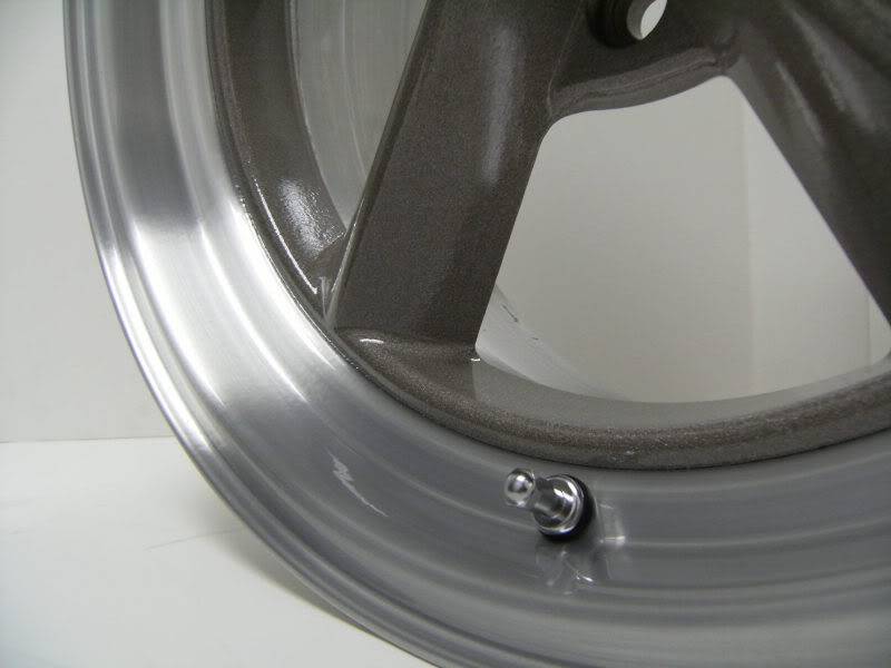

      Here are a couple pics to help you out.
      Smooth Lip
      Step Lip

      Smooth lip wheels look larger then stepped, due to the larger windows inside. Some people love this look (I do), some prefer the old school look of a lip...

      Smooth lip wheels locate that ridge further inboard, usually in the way of larger rotors and calipers. The templates for each are different, check your brake rotor/caliper clearances for each type of wheel you look at. As an example, a step lip 17" needs an 18" smooth lip to clear the same brakes.

      This is a smooth lip rim. Look Ma! No steps!!!
