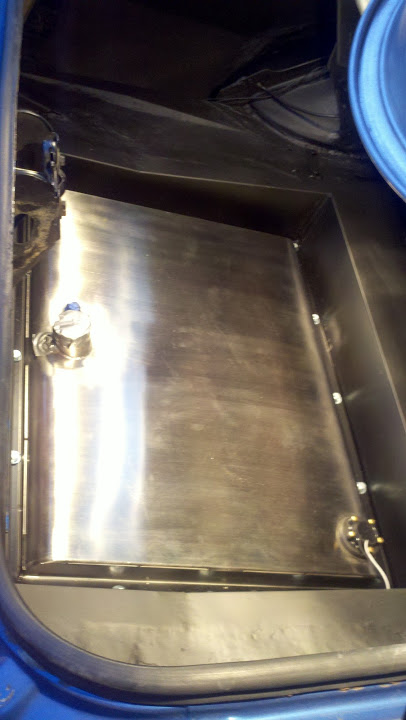

      Today I got the last remnants of the driver side quarter cut off and all ready to start fitting the new NOS quarter in place. I still need to prep and paint the entire inner structure to protect what is here from rusting anymore.
      I welded in the panel I made for the gas tank. I then used black seam sealer to keep everything water tight.
      Last test fit of the tank to make sure everything is still good. I am going to use button head stainless bolts to keep it in place.
      And a view from the bottom....

      I love the way the tank fits. It makes me think about removing my fuel cell. Great color combo too.

      This is a really easy upgrade for the tank. The best part about it over the fuel cell is that you get your trunk back! I used a 16 gallon 65-68 tank. But the 69-72 are 22 gallon. Same basic dimensions other than it is not flat on top, it raises up for the additional fuel. So the bottom, and the side measurements all remain the same. I didn't go that route because I figure after two hours or so of cruising I am ready for a break anyway. So no need for the extra gas.
      I went with a Ricks 22 gallon in mine. I had them center the filler neck also. I didnt like the tank be off sided. He was running a special on the 22. The 16 gallon would have cost about the same if not a little more. I have yet to top the tank off. LOL. My install looks a lot like yours except I made the tub a little deeper so that I could still have a flush floor.

      I love your install and tank. I was very close to going with a Ricks tank. But in all honesty it was just too expensive for me right now. I have been spending money like crazy lately and needed to spend a little wisely on this item. I also plan on making a cover like you did so I will have a nice flat floor. Nice job!!
