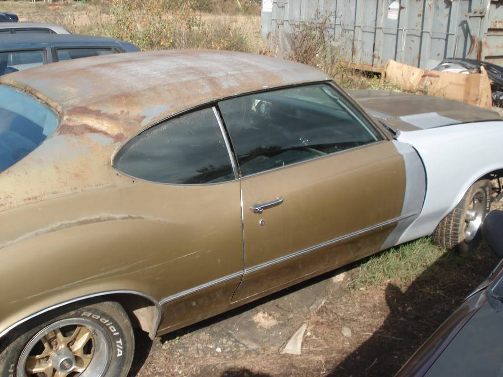

      Hello everybody my name is Da’Juan. I am a college student and rodding has always been my thing. This is my first main build. The vehicle is a 1970 Oldsmobile Cutlass S. I will be doing everything on this car myself paint, engine, interior. (Hope to at least) except for the rear and front seat upholstery. I will be having some custom parts also I will be doing. The bodywork will also be done elsewhere. I am not a stranger to taking advice, researching or asking questions. I hope I was not too lengthy. I just wanted to include my goals and what I have so far. This car will be 85% street 15% race/auto cross. Well I guess I will list the things I have now for project CUT-THROAT!! Tell me what you all think. Thanks a million.

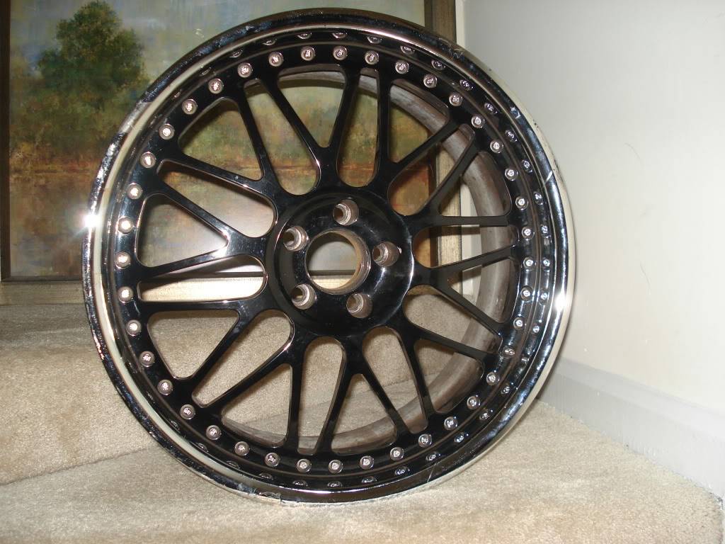

      Wheels: 2 piece with a bit of road rash but are 19x8 front and 19x9.5 rear. I have not bought tires yet but want some meat in the rear.

      --those wheels are going to look great on there!

      ^^ Thanks for the advice. The car is at the body shop now and will be out this weekend. I will post pics. My friends looked at me crazy when I told them I will be building classic car that will be powerful and have nice handling. But I guess they dont know Pro-Touring

      I've always like the Olds Cutlass. Those are some nice wheels you picked up man should like badass once refinished. Can't wait to see some updates for this.
