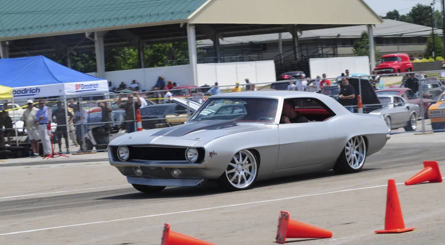

      Personally i would go 18s and 19s. The 245/40/18 front and 275/35/19 rear is the perfect combo for this. They give a perfect tire and wheel rake with both the rear rim and tire each being 1" taller then the front wheel tire package. And also maintianing the same amount of rubber around the wheels
      Here is a car we did with this exact package on it,
      You can see more of this car in Camaro Performers this month.
