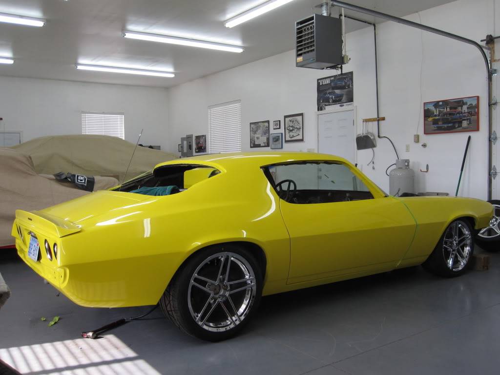

      I was gonna say keep the old wheels, but after seeing the Z06 wheels in it, man, they look plain mean. If you're gonna lay some stripes or some other accent to the body (black panels, I dunno), get them in that same colour.

      I love those Z06 wheels, they look like they fit perfect.

      Those Z06 wheels look awesome. I've wanted to put some on my '71 for a while now and I think you've made it final! Just a quick question. You mentioned that the car is minitubbed, just wondering whether you are running spacers on the rear end and is it the stock 10-bolt rear? Thanks and keep the pics coming!

      The car is minitubbed with the DSE kit to move the leaf springs in board. It does have the stock 10 bolt but if I remember correctly when I had new bearing ends put on it to elimnate the c-clips it ended up being an inch wider that stock so you may have to run a half inch spacer to get the clearence needed (They fit but its tight)

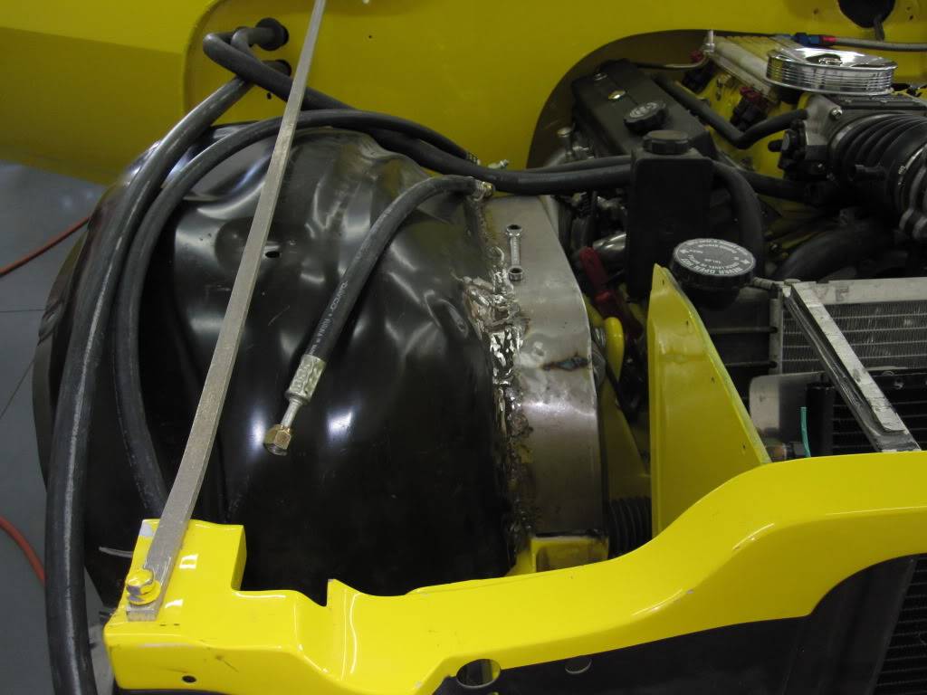

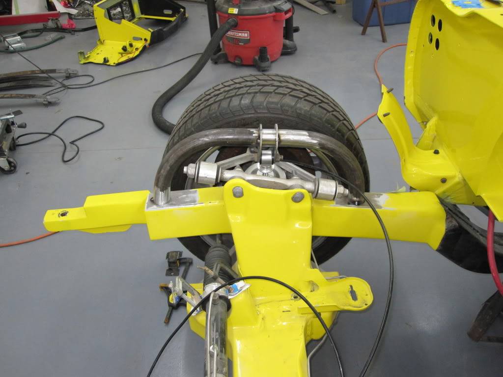

      Been awhile since I last updated been pretty busy on the car Have basicly been putting it all together to make sure everything fits before final blow apart and reassembly. Modified the inner fender wells to cover the new upper shock mounts.

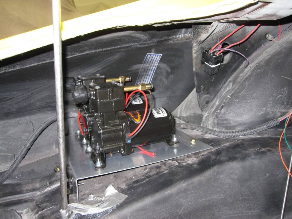

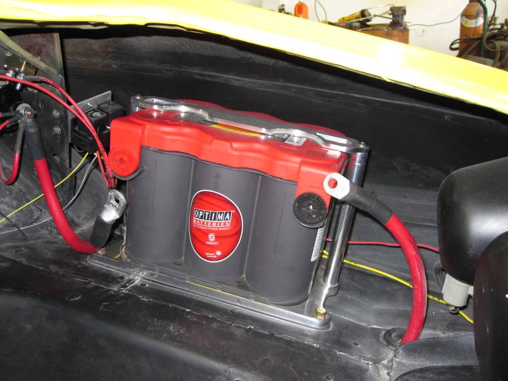

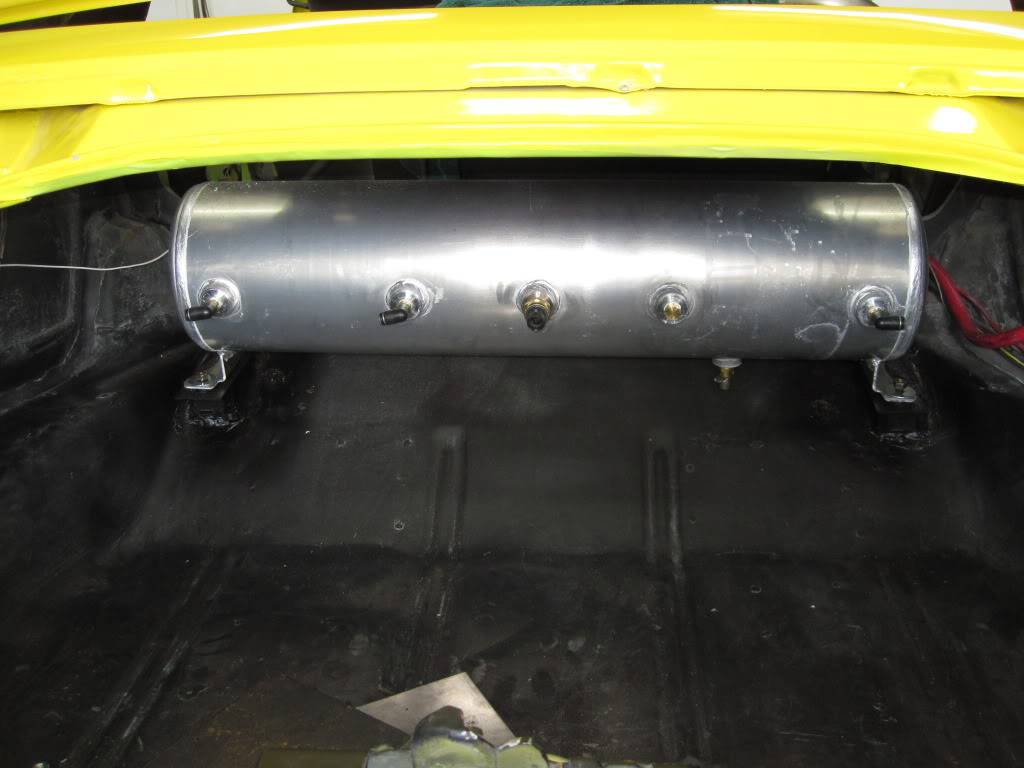

      Got the Ride Tech tank, compressors and battery mounted.

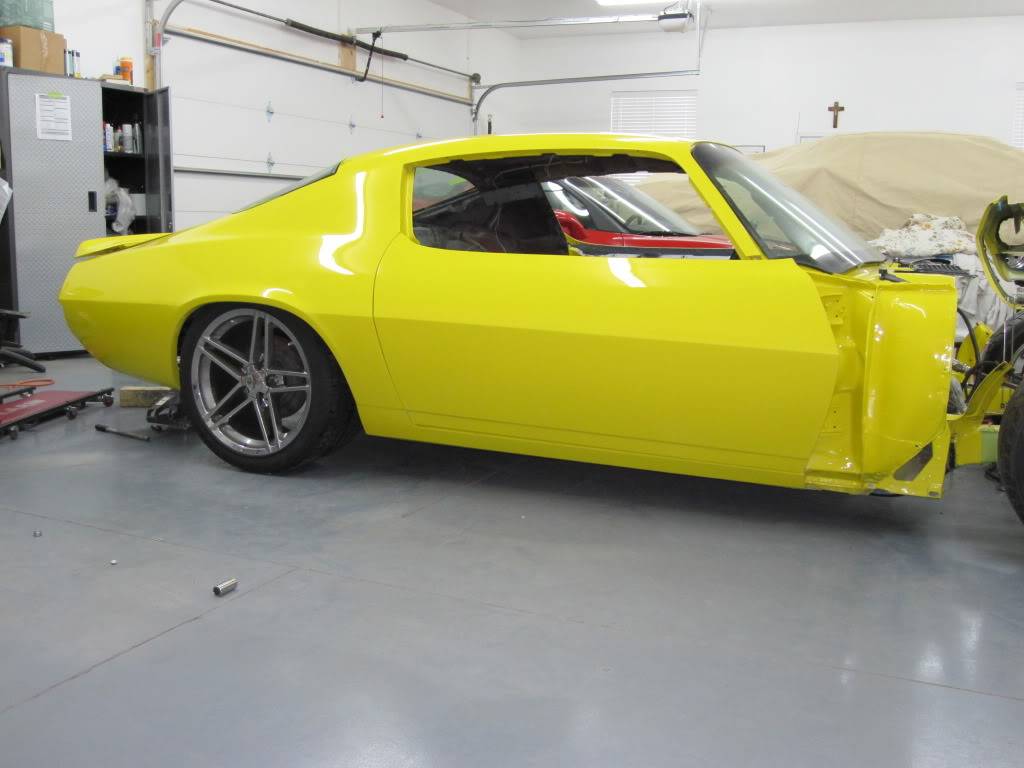

      This is how it looks with the Z06 wheels, this is at ride height.

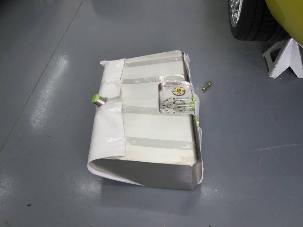

      Got my Rick's Tank the other day, Hector is a pleasure to do bussiness with.

      nice progress looks good!
      looks awesome with the rims!

      absolutely love the wheels!

      Thanks guys, I really like the rims also.

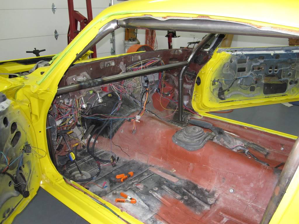

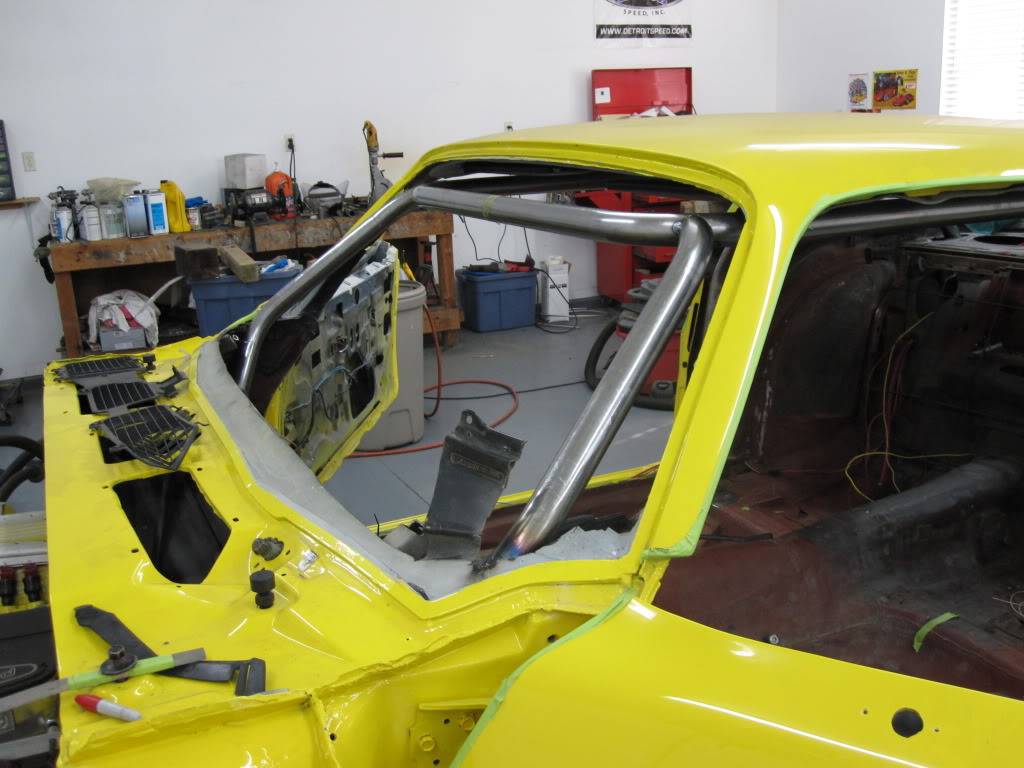

      Been awhile since last update, I have been putting a cage in the Camaro. I have the best friends in the world my buudy Steve loaned me is tubing bender and has spent many hours tig welding the cage in. Having a bender on site sure makes it easy to get the cage tucked in tight and the tubing run right where you want it.

      Looks great awesome project, the halo for the cage is to long, the a pillar bars need to tuck behind the a pillar, JMO
      Thall shall fear no amount of boost, For thy bottle is with me.......
      Oct 2007
      Goddard KS
      63
      The halo does look prety long with the windshield out but we did it that way si I could still have sun visors.

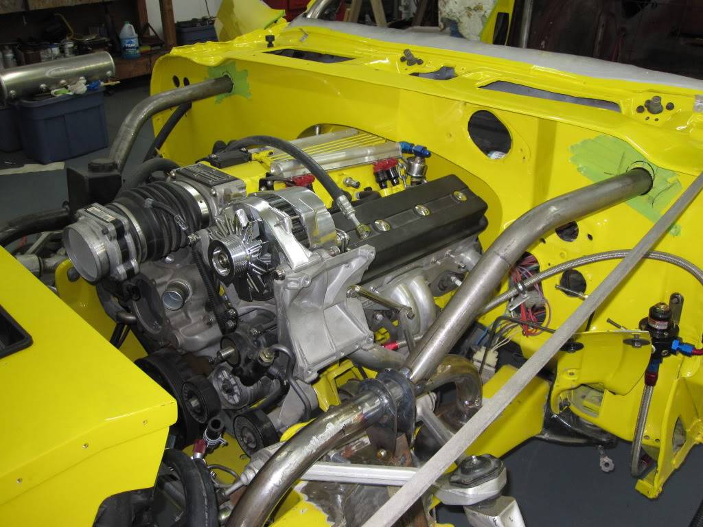

      Getting the drivetrain in.
