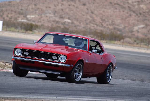

      Here's the same car from a distance:

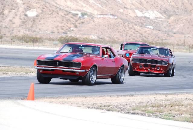

      Now look at two cars with camber correction:
      and the car above without:
      Notice how the top of the front tires on the cars with camber correction are tucked much farther into the wheel well than on the car without camber correction? That translates into speed and safety.

      Perfect example Mike. The gulstrand mod is not alot of work. It's simply drilling new holes in your control arm mounts. I would want to trim down the existing bracket on a stock sub to make it cleaner but I'm pretty anal about that stuff.
