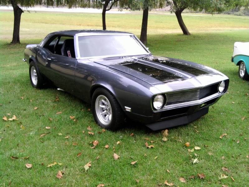

      My high school auto shop classes have worked with me for years on ProjectX2.
      Here are some pics of the car

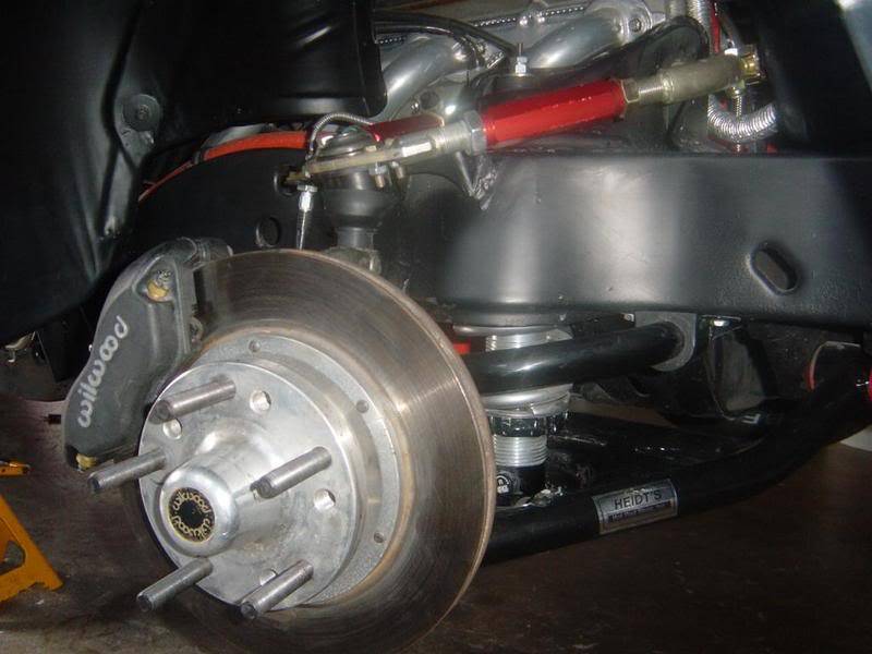

      Front Suspension
      After completely redoing the front suspension with poly bushings and painting the upper and lower a arms my Auto Shop students found Savitske Classic & Custom on Pro-Touring. I called Marcus and he suggested SC&C Pro-Lite Lightweight Adjustable Tubular Upper Arms. When they arrived we did the G Mod and put everything back together. Then my students found Heidts Lower control arms, Eibach springs, Wilwood brakes, Stainless brake lines, and Billet tie rod adjusting sleeves. I bought Goodyear Blue Streak Racing tires and put them on rally wheels.
      Then I found Minilites with Hoosier racing tires. The last and latest change was to remove the Edlebrock shocks and Eibach springs and install QA1 Adjustable coil-over Shocks.

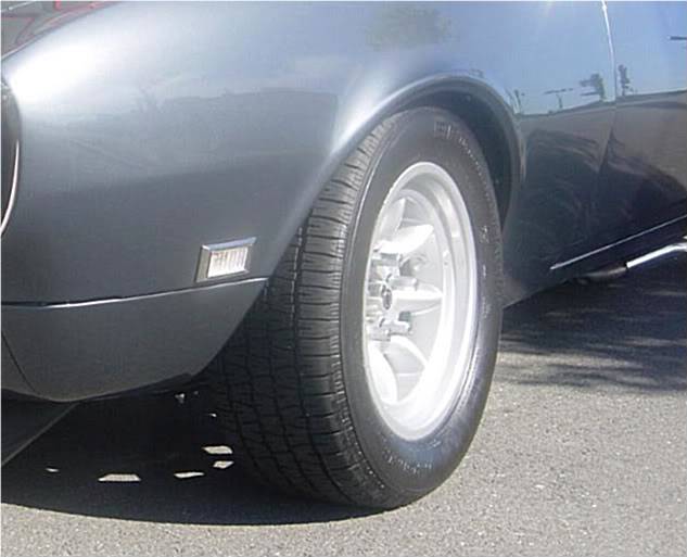

      MiniLite
      The Minilite wheels were 15 x 8 front and back originally. They came with Hoosier racing tires. There was interference with the front rims and the tie rod ends and upper control arm. I located Eric Vaughn Machine (http://www.ericvaughnmachine.com/) and had him narrow the front minilites to 7 inches. Eric did a fantastic job on the wheels which now fit perfectly. BF Goodrich Radial T/A 235/60 15 front and 245/60 15 rear tires were put on for the street.

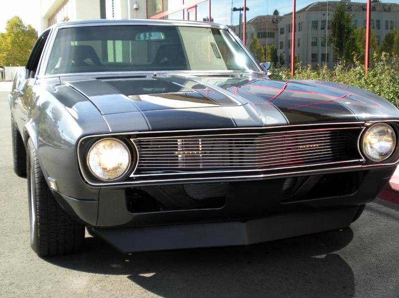

      Billet Grille and LED Running/Turn Signals
      I picked up a billet grille at the Goodguys Pleasanton swap meet and cut up a new grille that I purchases from Steve's Camaros (http://www.stevescamaroparts.com/) . Everything went together easily and I had to come up with some Running/Turn signals. I found Amber LED strips and had to wire in a dual element curcuit I found at Chrome Glow (http://www.chromeglow.com/) so the running lights and turn signals would work.
      You have to look carefully to see the LED's.

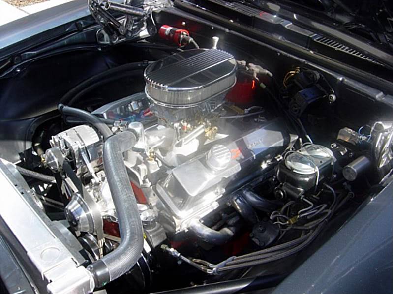

      383
      The engine is a 383. The students found a stroker kit from Powerhouse Engine Components (https://shop.enginekits.com/osb/specials.cfm). I took the 4 bolt block to Smeding Performance (http://www.smedingperformance.com/) for machining. I picked up a cam and other parts there and had the students help put the engine together using ARP bolts. We called Trick Flow and ordered a set of aluminum heads. A large order to Summit helped finish the engine.

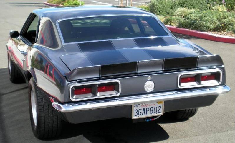

      Fesler Billet Taillights and Air Ride Billet Gas Cap
      My students saw the billet gas cap and the billet taillights on Pro-Touring.
      I called Amy at Fesler Built (http://shop.feslerbuilt.com/main.sc) and ordered the RS Billet taillights with anodized finish. They are awsome.
      The billet gas cap became available from air ride Technologies (http://www.ridetech.com/index2.html) and was ordered. It fit perfectly.

      First Outing
      Drove to a friends birthday party/car show. Shake down cruise went well. Exhaust needs some work and a few other things turned up that need looking into. All in all a GREAT day.

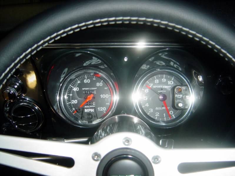

      Dash
      I put the dash instrument cluster back in the Camaro today. I had it out to put the billet gauge bezels on the Auto Meter Speedometer and Tachometer. I got the bezels from Steve at Twist Machine (http://twistmachine.com/shopping/). He had some bezels w/o the holes made up for me. They fit perfectly with just a little modification where the tach contols meet the bezel.
