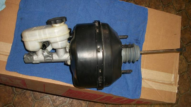

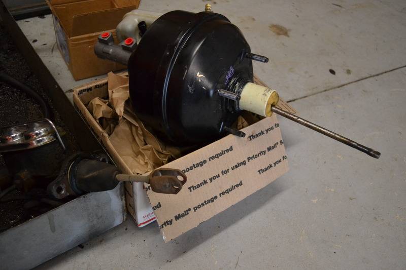

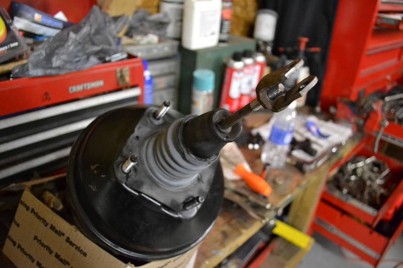

      Ran across this old pic of the master cylinder and booster:
      Pete

      Vicinity and Pete.. for the 4th Gen Booster. Do you know the Rod's travel is ?.. I have mod'd my 4th Gen Booster as you did and now have it mounted up. I have two holes on my 71 Nova Pedal and want to make sure it will travel the correct amount..
      Thanks..
      BC
    11. #91
      Jun 2009
      Central FL
      1,231
      Quote Originally Posted by bczee View Post
      Thanks..
      BC
      I checked before I put it in, but I do not recall what it was. I do remember welding the threaded portion right on the end of the booster rod and mounting it against the firewall provided more than enough travel.
      Dan
      1968 Camaro v2
      LS6 :: Viper T56 :: C5 Brakes :: Hotchkis Suspension

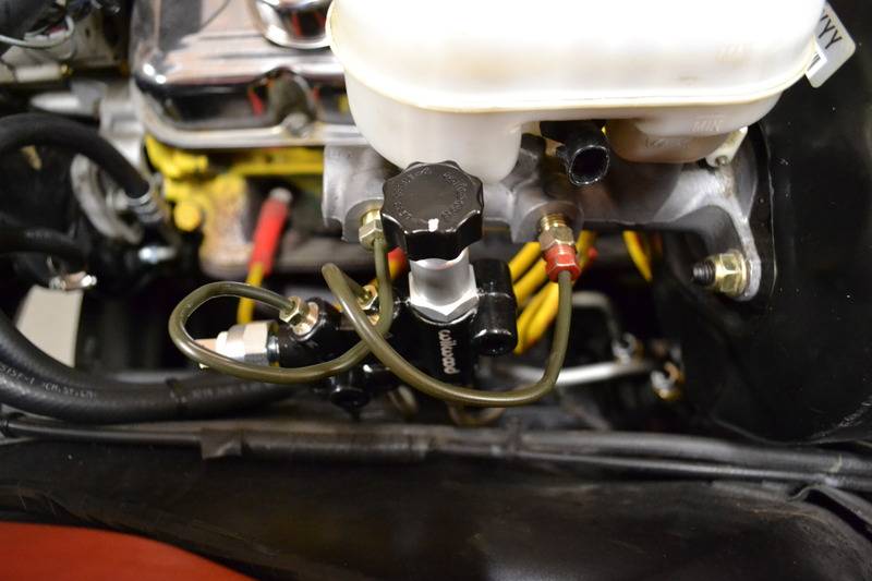

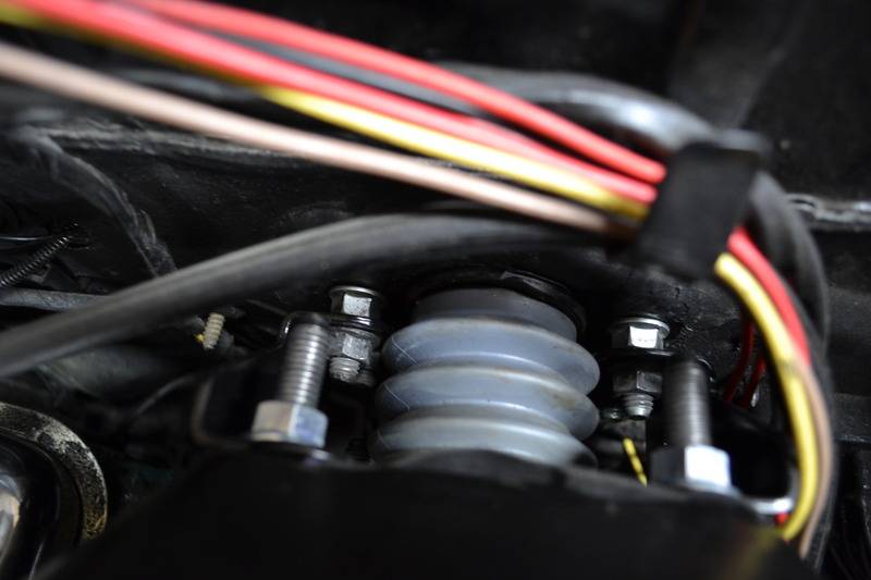

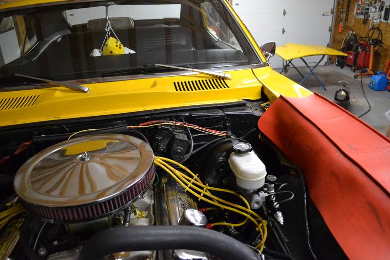

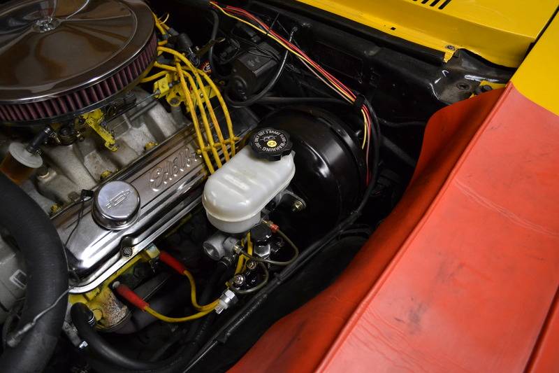

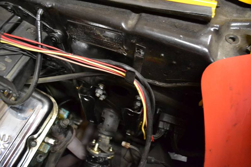

      Got mine done this week, here are some pics for anyone else interested in this swap!
      I got some $15 brackets from Summit. I liked the reduced angle ones like DSE, but I was apprehensive about trying them since they say "for DSE booster only". These worked perfectly, and I didn't even have to open up any holes. I just used 2 nuts as shims, and it gave me the perfect angle I was looking for.
      And my Wilwood adjustable proportioning valve.
