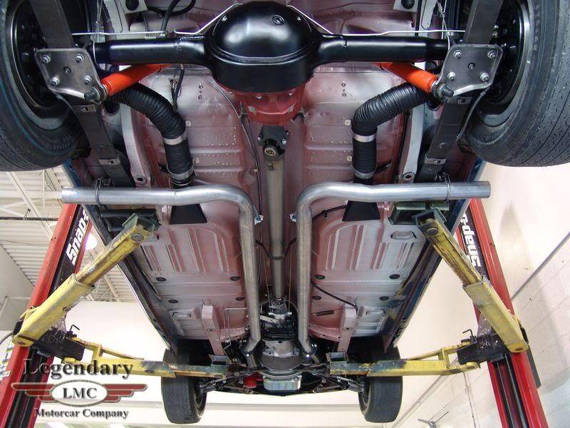

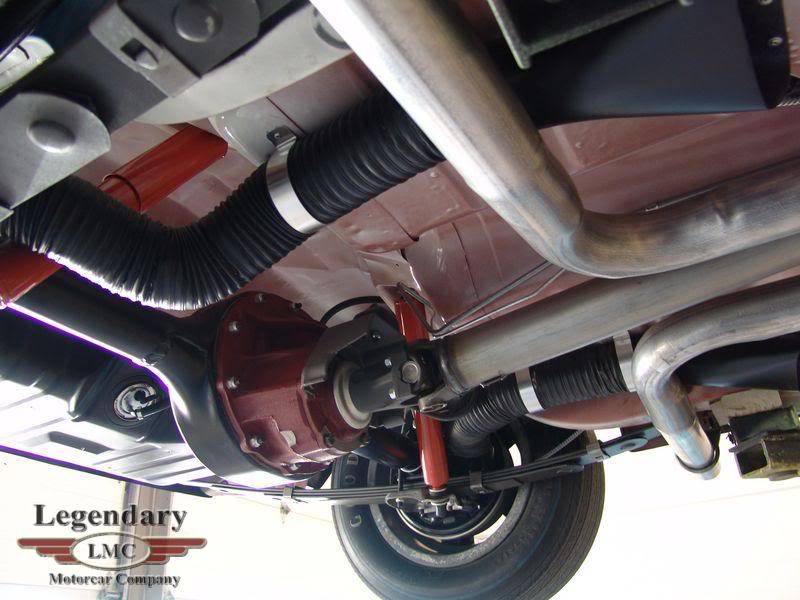

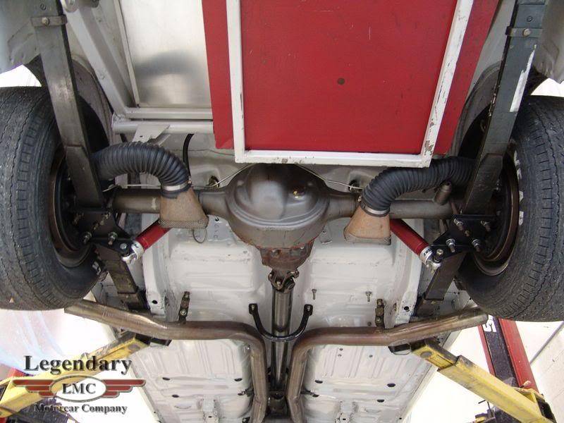

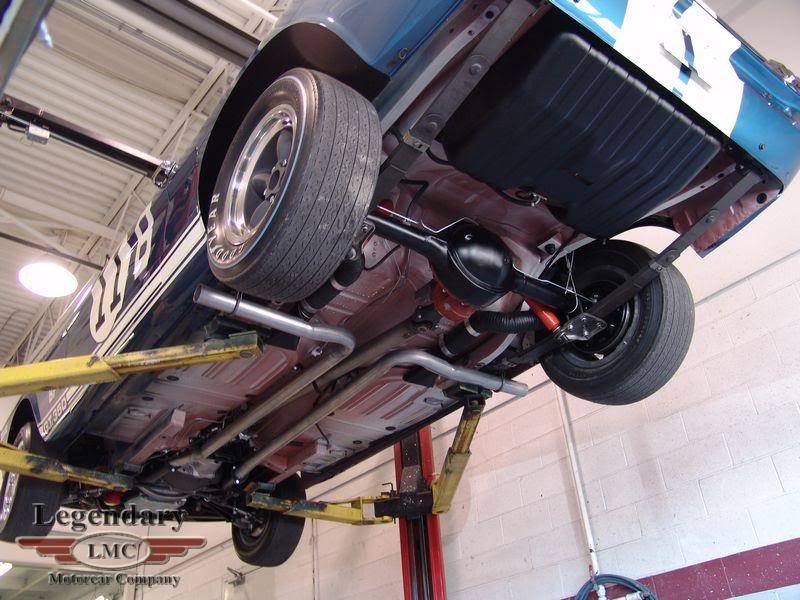

      well i was looking around the web for ideas for my cutlass. since im building a road racer car. and i stumbled across this:
      look at the black tubing. i know this is a GT350 but i would really like to do something like this on my 79 cutlass. do you guys think its possible and if so how would i do that?
      thanks;
      vlad

      You could do it exactly like those guys have done it... but I'd think you need it more for the front brakes.

      I'm kinda curious how hot the air would be. For a car with no vents in the hood or fenders, you'd be pulling air off the hot engine, exhaust and tranny. But... I don't know what brake temps are... maybe the 200-300 degree heat would still be cool enough to help.
