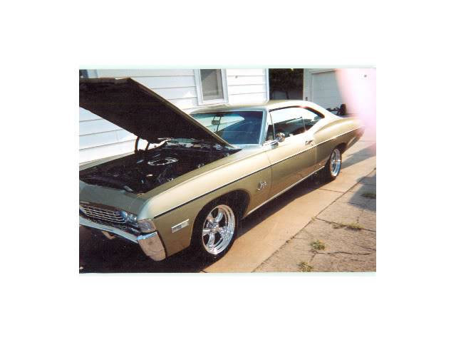

      Here is what it looked like before I tore it down

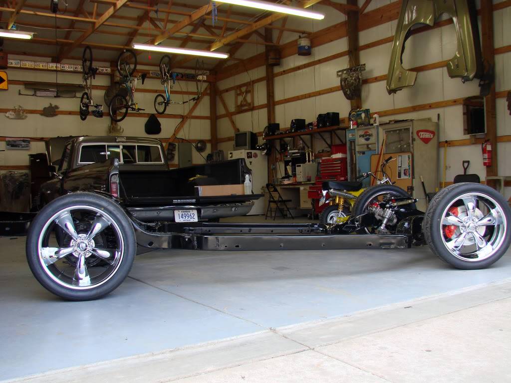

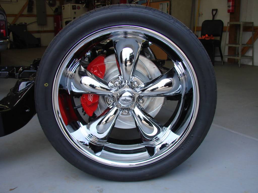

      Some pics of the chassis. Test fitted my brake kit the other night. Gonna bolt on the rotors this weekend.

      Thanks. Got the front brakes all bolted up today. SSBC is a pretty good kit, I am happy overall with the looks and ease of the kit.

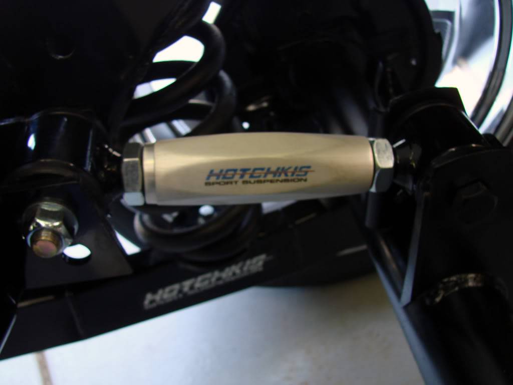

      My rear end is getting ready to go be assembled, so in the mean time we had a spare rear end that we put in to test out all my rear suspension parts. It was a easy install, only took a few mins and I was able to get the frame off jack stands, I was pretty pumped.
      All the Hotchkis parts went in smooth with no problems, they make great parts and nice quality

      Frame on the ground! feels good
