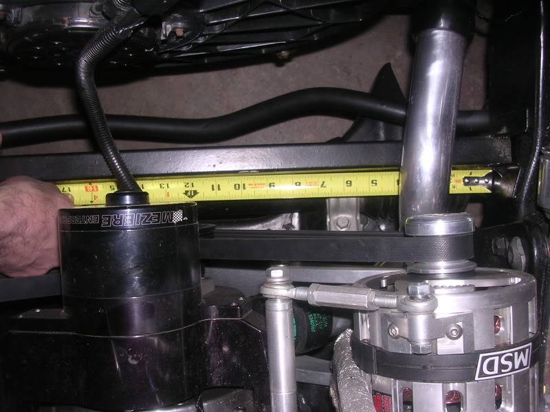

      I also took some measurements on engine placement. I was wondering how offset the original SBC was offset to the passenger side. My factory engine mounts were cut off by the previous swapper. Looks like ~2" offset to passenger. Crank centerline was 15 1/4" from the frame driver, and 13 1/4" to passenger frame as measured along the cross bar in front of the engine (the pic is taken from an angle).
      Any one have differing info?

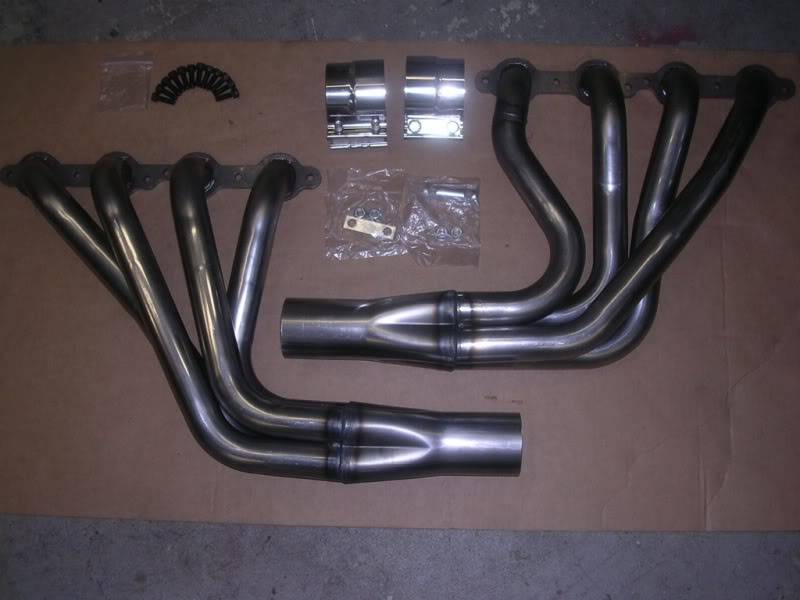

      My Melrose LS1/C4 swap headers came in. I am impressed. Build quality and hardware are top notch! I ordered mine uncoated. I want to go flat black with them. I intend to use header paint. If that fails, I can always get them coated later.

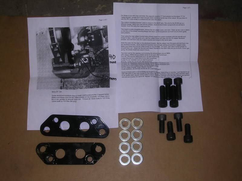

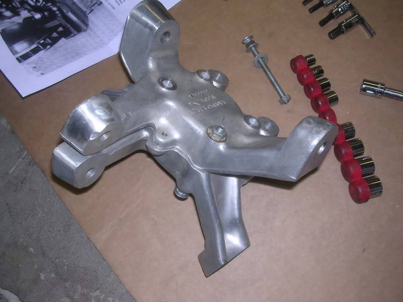

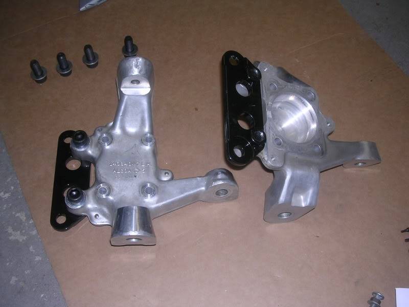

      I also received my C5 front brake brackets. I got them from a forum member. Again, build quality and hardware were impressive. I mounted them on some 85 spindles I picked up (because 84s have smaller/weaker mounting bolts). Although I do not yet have my new rotors or hub/bearings so a full mach-up will have to wait.
      Spindles came shockingly clean, and cleverly bolted together for shipping.

      Those headers look really nice. They don't look anything like my Corvette headers,lol.

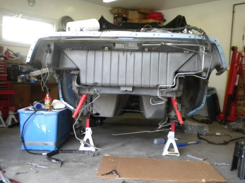

      I have the entire rear suspension out (actually the entire drive-line) along with the rear facia, bumper support and gas tank. The New (to me ) D44 was checked out at the shop. Banski rear suspension is in the mail.
      I have finally started the re-assembly process by installing the new Classic Tube fuel line.
