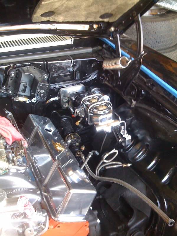

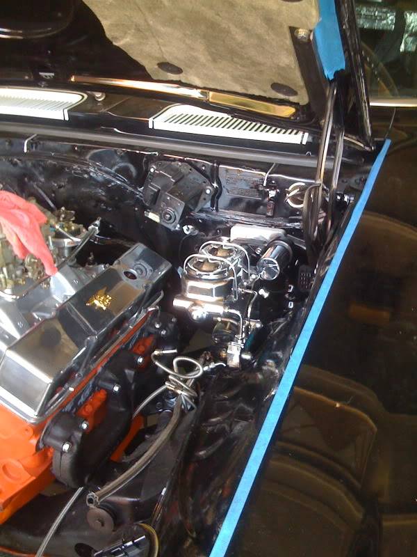

      I used CPP's new MCPV-1 M/S nice looking piece with integrated Prop valve and max rear pressure adjustment
      http://www.classicperform.com/NewPro...V-1/MCPV-1.htm
      Here are a couple pics installed:
