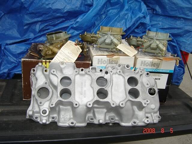

      Next method is to send it out to be 're-skinned'. That process is used by restorers to reproduce the original 'as-cast' finish. I'm not 100% sure what they do to get the metal down to 'spotless', but the final step is to put the manifold into an oversize tumbler with rubberized abrasive beads. This process "closes" the pores that were put there from blasting or were left from casting, by 'wearing down' the surface. Here's a before and after of the 67 manifold.

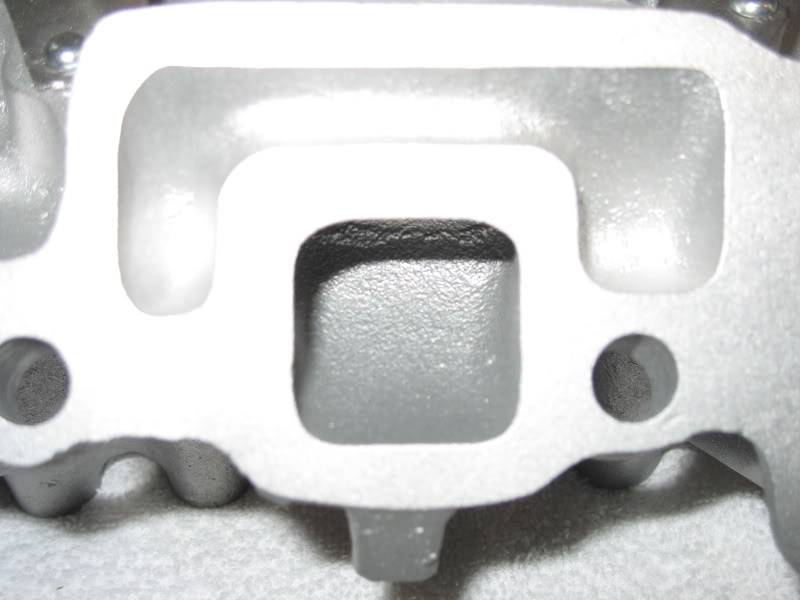

      This is the heat riser passage. It was choked with exhaust carbon when I sent it out.

      [QUOTE]That process is used by restorers to reproduce the original 'as-cast' finish. I'm not 100% sure what they do to get the metal down to 'spotless', but the final step is to put the manifold into an oversize tumbler with rubberized abrasive beads.
      That looks like shot blasting. Clean fresh cast look not chalky like bead blasting/sandblasting.
