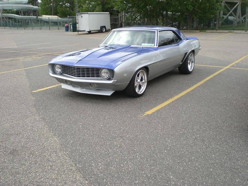

      I painted them silver I think it looks really good

      I know it is not a 69, but all trim has been powder coated. Trim was powder coated approximately 20 years ago, not one scratch/ chip.
      https://www.pro-touring.com/forum/at...3&d=1192063450
