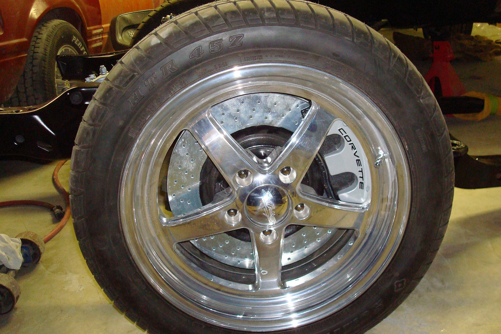

      I have 2008 Z51(13.5in rotors) Brake Kit on my '72 Camaro, I had to shave the fin alittle and use a 1/2 inch wheel spacer.. This was fine since I ordered the front wheels with an extra .5 of backspacing.. This is with a 17x8 wheel w/ 6.0in backspacing..

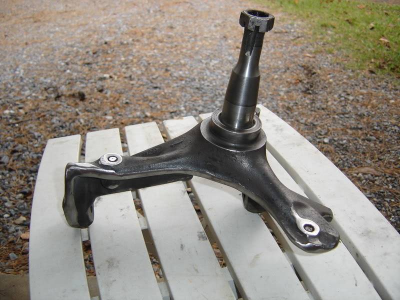

      Basically trim off the mounting points for the stock hardware, drill and tap two of the dustcover bolt holes to fit a 1/2x13 bolt, then you have a modified spindle ready to accept the Kore3 C5 bracket.
      stock brake mounts have been cut off, still need to drill and tap the dust cover bolt holes...but this should give you an idea of how much cutting is involved.

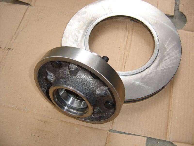

      Here is a pic of the modified hubs cut from a 3G F body rotor.
