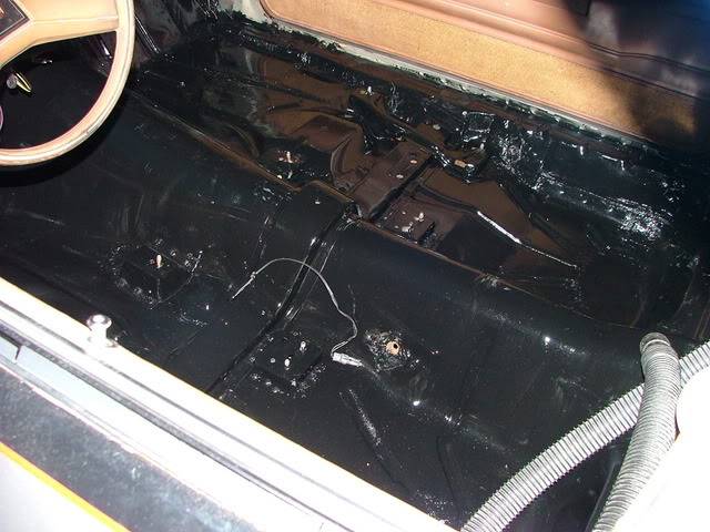

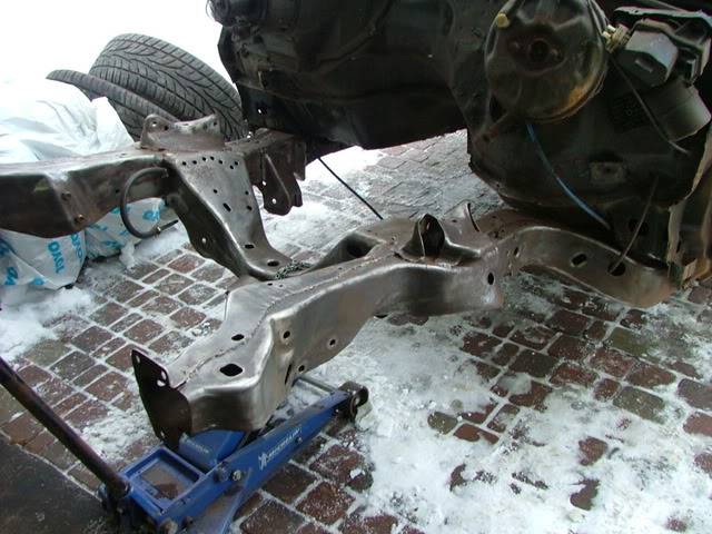

      Well I was thinking it was time to represent the G body side of things, so here is my latest build, a 78 Malibu. As you may have noticed from my tag I used to have a 79 Malibu but sold it a few years ago. This one was started over winter in a one car garage. I stripped it right down and did some floor repair and replaced the body mounts, all the suspension, all the lines... The drive train consist of a 95 lt1 4l60e combo with a Street&Performance wiring harness and MSD billet optidrive. The brakes are C5 on Blazer spindles front and rear with matching booster/master and KORE3 stainless lines. The wheels are 17"EAGLE ALLOY 212. I am now in the process of exhaust and finishing the interior.

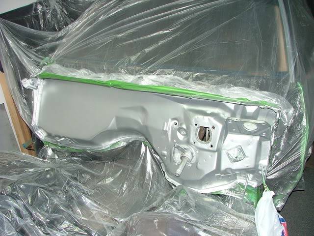

      I love how clean the firewall is. Alot better than just bolting up a block-off plate.

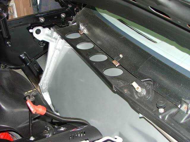

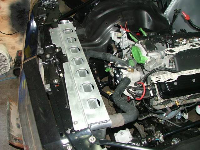

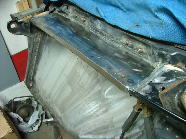

      That firewall sure looks good. It looks like you welded the end of the "shelf" to the end that stays there after the A/C box is removed - I would like to know what you did do to support it along the length of the "shelf"? Did you weld that also? or use the bolts off the supports for the wide stainless trim ?

      On second look I see that you welded it across the cowl. And looks like you'll be using a straight cowl to hood weater strip seal. Very nicely done.

      Thanks for the comps guys, ya the pics got screwy, need to address that if future posts. As for the firewall shelf I welded it across then welded a lip to give it a factory look, then cut holes in it to aid in venting engine heat.
      firewall pic

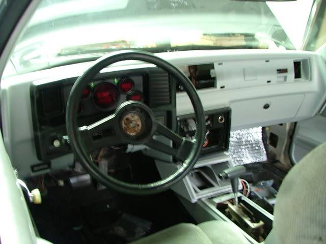

      interior almost complete

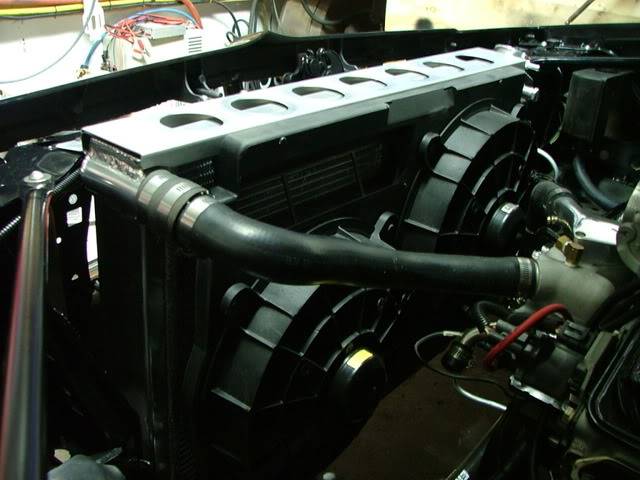

      The color will stay, not the best paint job but good for now. Taking my time on this one, gotta balance between the toy's and family. I installed the headers and rad today, would like to get it running before the snow flies and take it around the block.
      Ottawa Ontario Canada
      17

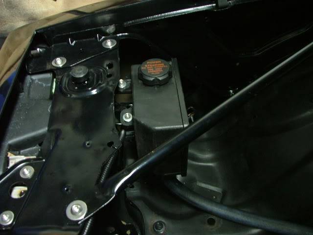

      78 build update
      got some work done over the long weekend.
      power steering reservoir mounted

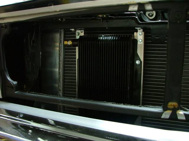

      trans cooler mounted, gotta flair up some lines
      and the Camaro fans all mounted
