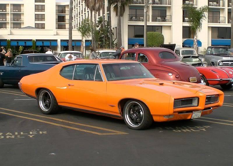

      I have Hyperco springs from Speedway Motors. Specifically these. I run the 175 rate. There is a 150 rate. They run about $50 each.
      The springs are 11 inches long with a single pigtail and work with my 68 spring pockets. This drops the rear quite a bit:
      The rear tires are 26.4 inches tall.
      They also have 12 inch springs here for a little less drop.
      Stock springs are about 14 inches long with about a 120 rate.
