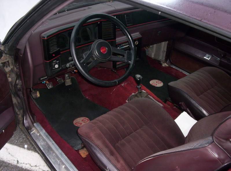

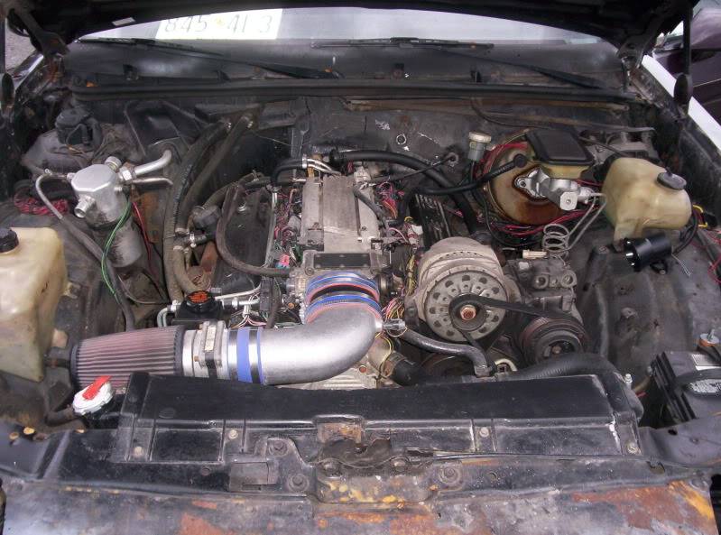

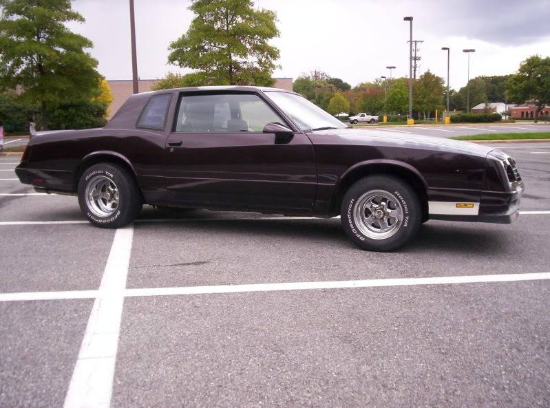

      Well here is My 1988 Monte Carlo SS. Motor/Trans is out of a 94 Camaro. Hope to upgrade the suspension and brakes soon and maybe even paint it. Enjoy
      P.S. Everyone says "I didnt know these came in 6 speed"

      Im looking at doing a t56 swap in my 83 buick, what did you do with your pedal setup and would it be the same as my buick
      -Gibson-
      Eastern Virginia
      3,963
      An 83 buick would be the same. I got lucky & found an el camino in the junk yard years ago with a manual trans. Got the pedals for $25. There are aftermarket ones out there, or get just the clutch pedal, & trim down the brake pedal.

      What kind of cars do I need to look for for the pedals? I have a set of 1st gen camaro/firebird clutch pedal setup would that work?
      73supreme455 That shifter is a vette shifter with reverse lockout correct? that would not have come on the t56's in camaro's and I thought the vettes used the ZF6 6-speed, ive always like that shifter will it bolt up to the t56 and still utilize the reverse lockout?

      Finding a set of G body pedals today are probably slim to none. They were available in 78-79 Montes & Cutlases, 78-mid 80's El Caminos & Malibus. You could modify a set of F body pedals, use the pedals themselves on the G body mount.

      One of the suppliers- I think it's OPG- repop the entire mechanical linkage for G bodies

      Someone on Montecarloss.com (I think) advertises a clutch pedal to add to the G body setup, you need to trim the brake pedal to be smaller & the clutch pedal just bolts on. I'll see if I can find it.
