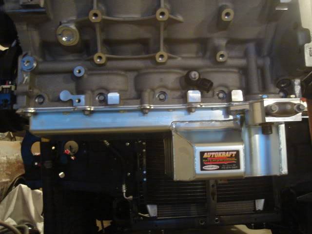

      I chose the Autokraft pan, also sold under another brand name that I can't recall. It's priced at $399.95 right now.
      It fits along with the Edelbrock engine mount adapter plates and headers I'm using.
      Made for the '64 -72 A-body cars and '67 -'69 F-body cars and doesn't require the use of a remote oil filter if that matters to you.
