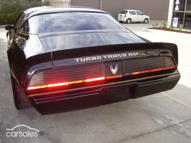

      Leigh can you get a picture of the 79-81 lights? I'd love to see them. I'm glad to see the car is coming along nicely.

      Quote Originally Posted by WS6 View Post
      Pretty lousy picture, but I hope you get the idea.....the smoked covers don't make them as noticable as mine.
      Can also go to http://www.carsales.com.au/all-cars/...carhome&Nne=15
      Which is a car sales site in Australia....fair few 79+ T/As on there for sale to look at.
