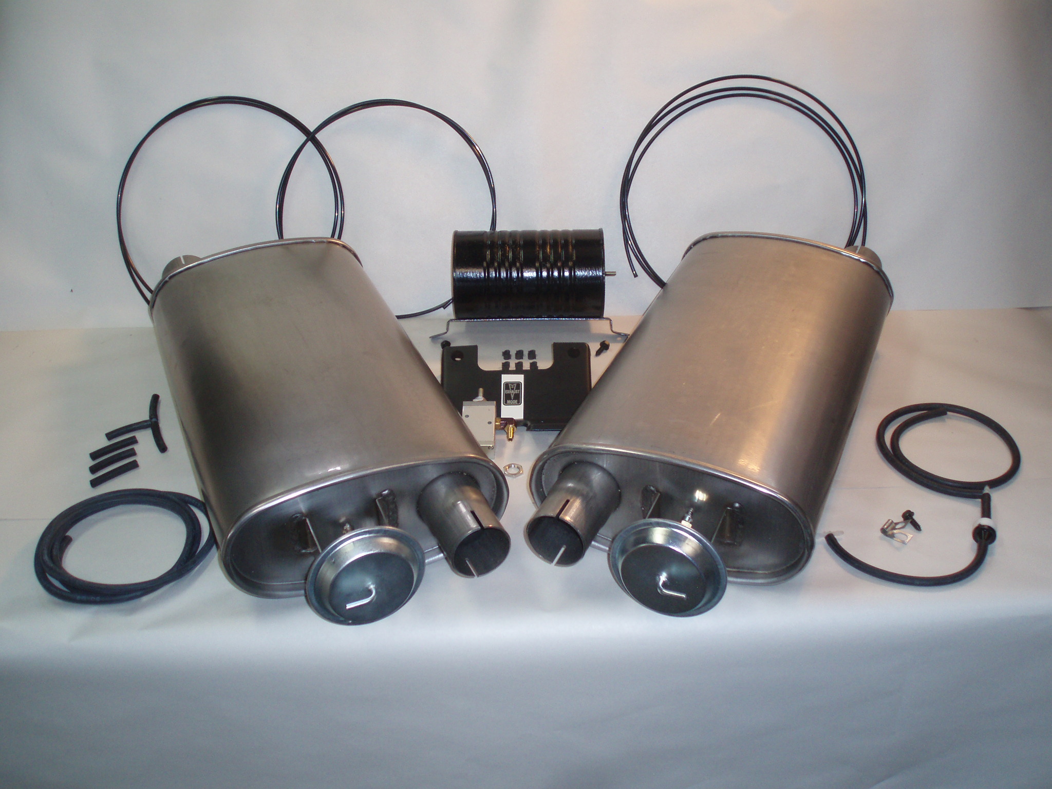

      3. The new Stainless Steel version of the 1970 GTO optional VOE (Vacuum Operated Exhaust) from Waldron Exhaust....driver control of exhaust flow path through the mufflers for normal sound or louder/deeper full flow sound.
