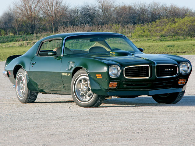

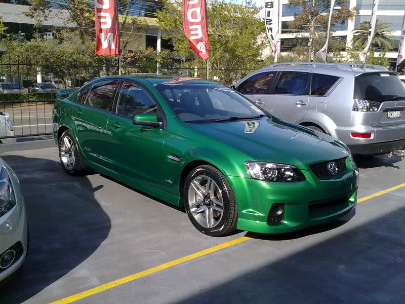

      Colour choice......
      well, I won't know for sure till the paint is in the gun, but I'm looking at white with an offset blue racing strip on hood and trunk with a blue tail panel......
      or this metallic dark green thats a late model colour on the local Commodore (Pontiac G8).
      or

      This is the final choice...green pearl....factory GM colour.
