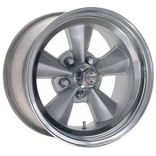

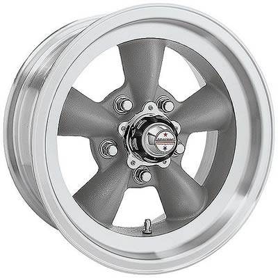

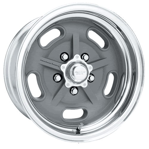

      Here's the wheels I'm digging. This is a smaller car. 100" wheelbase. I'm thinking I won't go bigger than 17's. 15" and 16" will fit much better, but I really wanna get some 17x9 or 17x9.5 in the rear and some 17x8 up front. The tire size I'd like to run would be 205/45/17 or 215/40/17 in front and 235/40/17 in the rear. I really dig the grey painted wheels in these styles and maybe paint the car in its original off white/light beige color?

      Those wheels are too big for those tires. I'd look to a 17x7/17x8 rear combo if thats the widest tires you can run.

      Quote Originally Posted by 68Formula View Post
      Nah!!
      No clue if that wide of rear wheel can fit, but that's what I'd want to shoot for. Looks cool to me!

      Craigs73, great call man! I dig those. Have that Trans Am feel. Love the painted look and polished lip.

      yeah i really like them i would get them for mine but already have wheels and not only that there expensive
